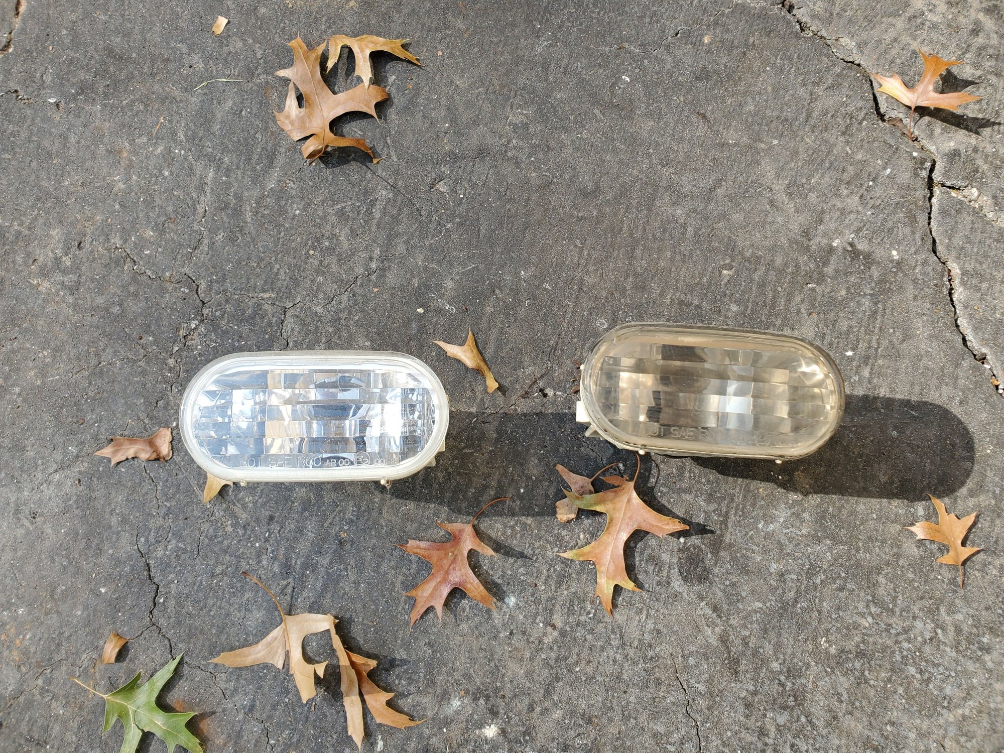

Also changed out the reverse lught today.

The backup light is quite the improvement.
