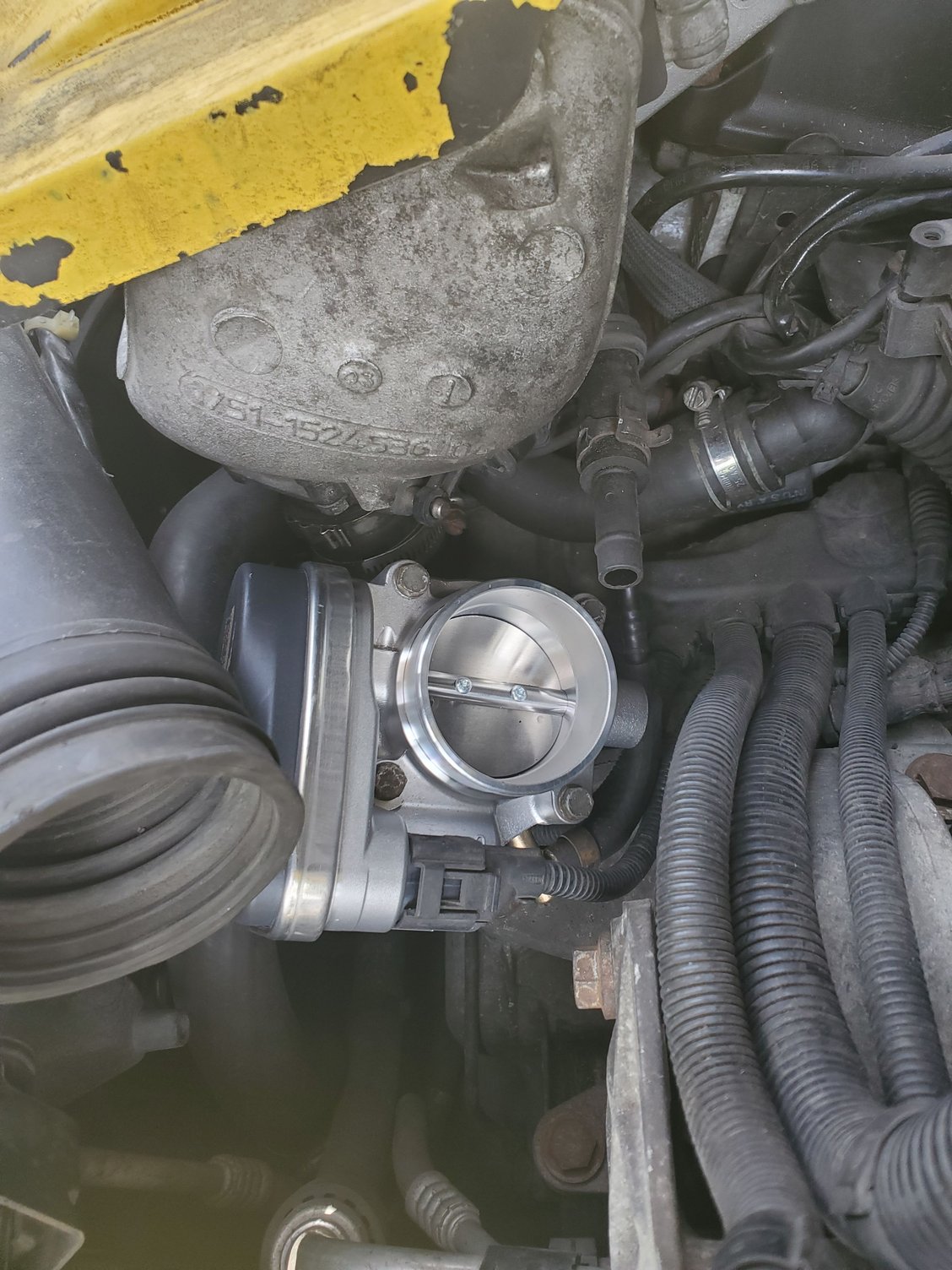

Overdue update! Grumpy is less Grumpy, again. Ditched my old SnapOn Verus Pro for a new Autel MS806TS and got his adaptations reset. Along the way his throttle body crapped out and would randomly stop working causing the idle issue, and sometimes rendering him inoperable while driving due to no throttle response. Sourced a new VDO TB from FCP Euro (on sale, too!) and most is right with the world. TB went in last weekend, adaptations got reset Monday, drove him home Monday night and back to work Tuesday morning, all monitors were set and he got his fresh inspection stickers.
Today I finally got around to replacing his fuel filter. My God was that thing nasty! I think it was still original at 190k miles. Not too bad, but should have done a bit more research and would have known not to try to pull the whole assembly out. Tank was pretty empty so it was pretty easy to fish the spring for the level sender out, and I think it all went back together and stayed together ok going back in.
Next on the list is a full belt drive refresh. Got a Continental kit from Rock Auto, just haven't had time to install it. Also starting to put together a cart at Summit Racing for an exhaust refresh. The one ball exhaust has pretty good leak from the corner of the muffler, so it's definitely time.
New TB in place
