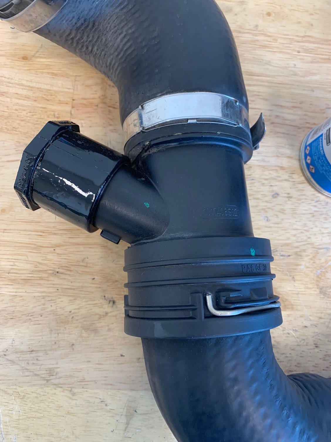

If you don't recognize this part, this is the Auto Trans Shifter release. I knew this was a problem back when I purchased the vehicle and luckily they sell this part individually. You have to drop the exhaust, then remove the heatshield from the tunnel, then drop the shifter assembly from the bottom. It's an easy fix once everything is off. You DON'T have to completely remove the shifter assembly. Just remove the 4 bolts from the under side and it will drop down to allow you to fix it under the vehicle.

- Leaking Turbo. The seals inside the turbo allowed oil to cross over. The intercooler had a lot of oil in it. New Turbo.
- Due to both the block and the head being shaved to achieve flat, a thick gasket was needed. Chunk the oil (which was still new), then install the thicker version.
