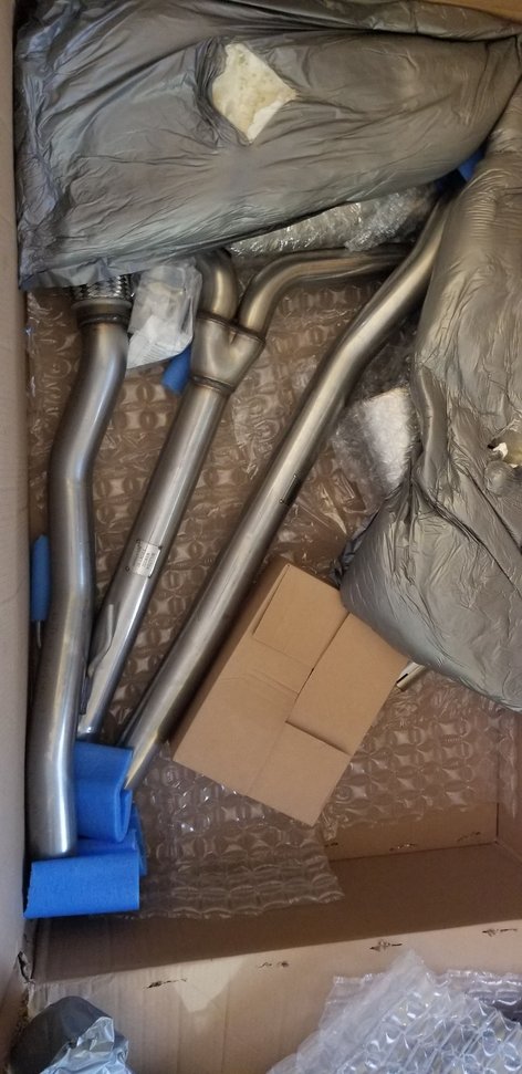

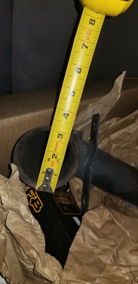

More excited than i would be for christmas, exhaust came today!
Ooh boy do you look pretty
Nicely packed!
And there it is guys!
Though it may look like it there is no rust on those welds.

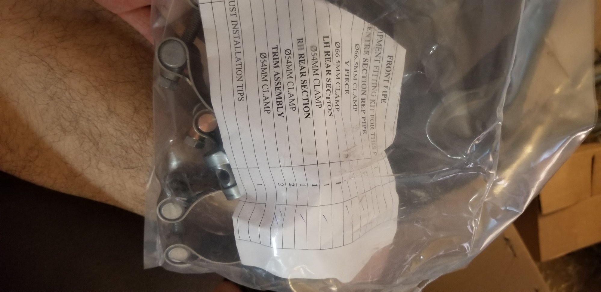

Comes with all the hardware clamps and such

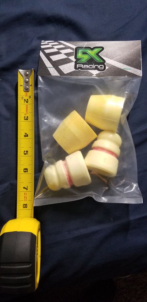

Ok so jacked up my car today to pre-plan for parts installation tomorrow. Discovered i am missing a socket deep enough for the clamp connecting downpipe to front pipe for exhaust . I will have to make due with a 16mm crescent wrench or maybe when i drive down to where my parts are I can hit an autozone for a deep socket. Stay tuned, tomorrow will be air charge pipe, air discharge pipe, exhaust, and maybe cai (still on the fence as i dont want the extra air confusing the ecu and making it run lean).
Also decided on the tron led tail light for the clubman from my man Aaron from Outmotoring which i will order in october from my next bonus. Also found a forum member who will be sending me (im paying obviously) his own designed front splitter and it'll be under half the cost of other big names. After studying Sneed's and M7s install sheets i think the hardware needed can all be found at Home Depot plus some stanchions from Amazon, shouldnt be more than maybe $50.

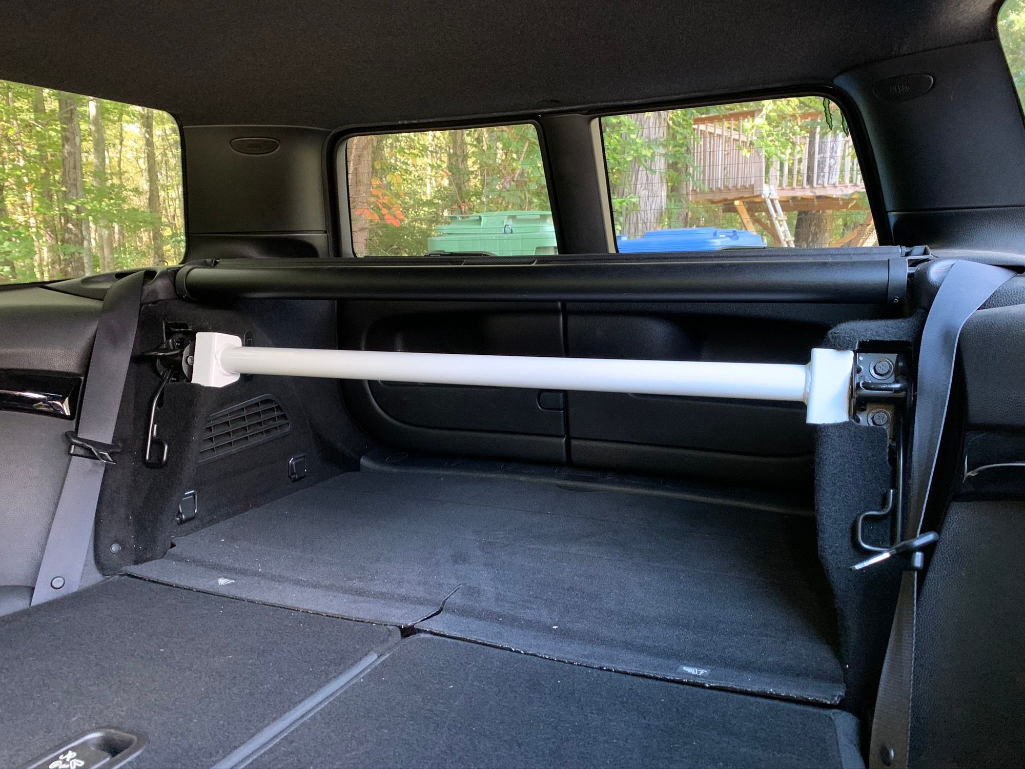

Originally Posted by njaremka
No instructions or hardware were included, just the bar. It was a tight fit getting the bar in, but it’s in. I bought it off eBay, at a total cost of about $150.
Just dropping some pictures in here...

I don't see where it bolts up to. Looks clean as heck though. White is one of my favorite colors when paired with a nice dark color either purple or black. Looks great man!
It bolts down between the rear seat bracket and the bulkhead. Only modification for installation was to trim the carpet where it interfered with the bar.

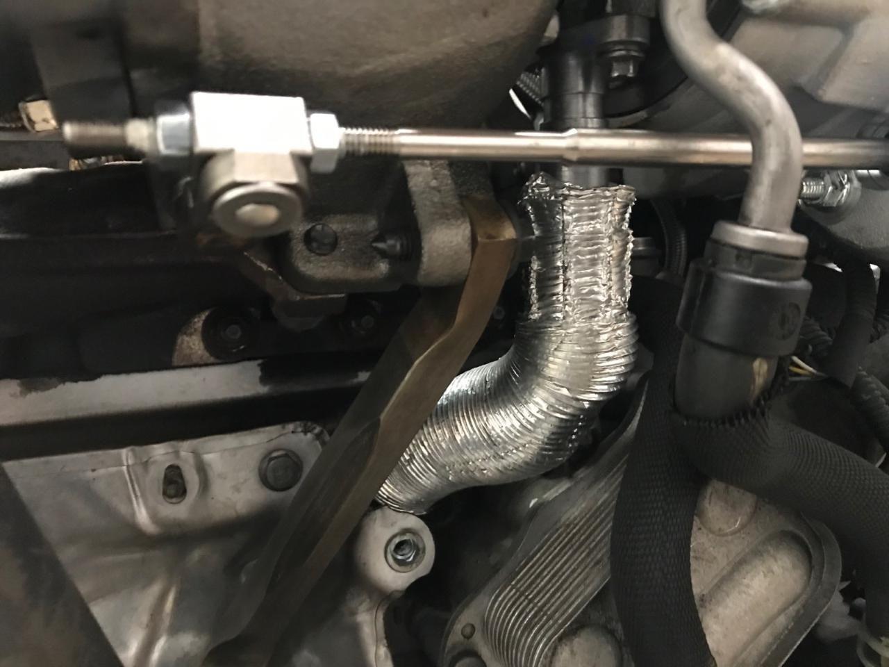

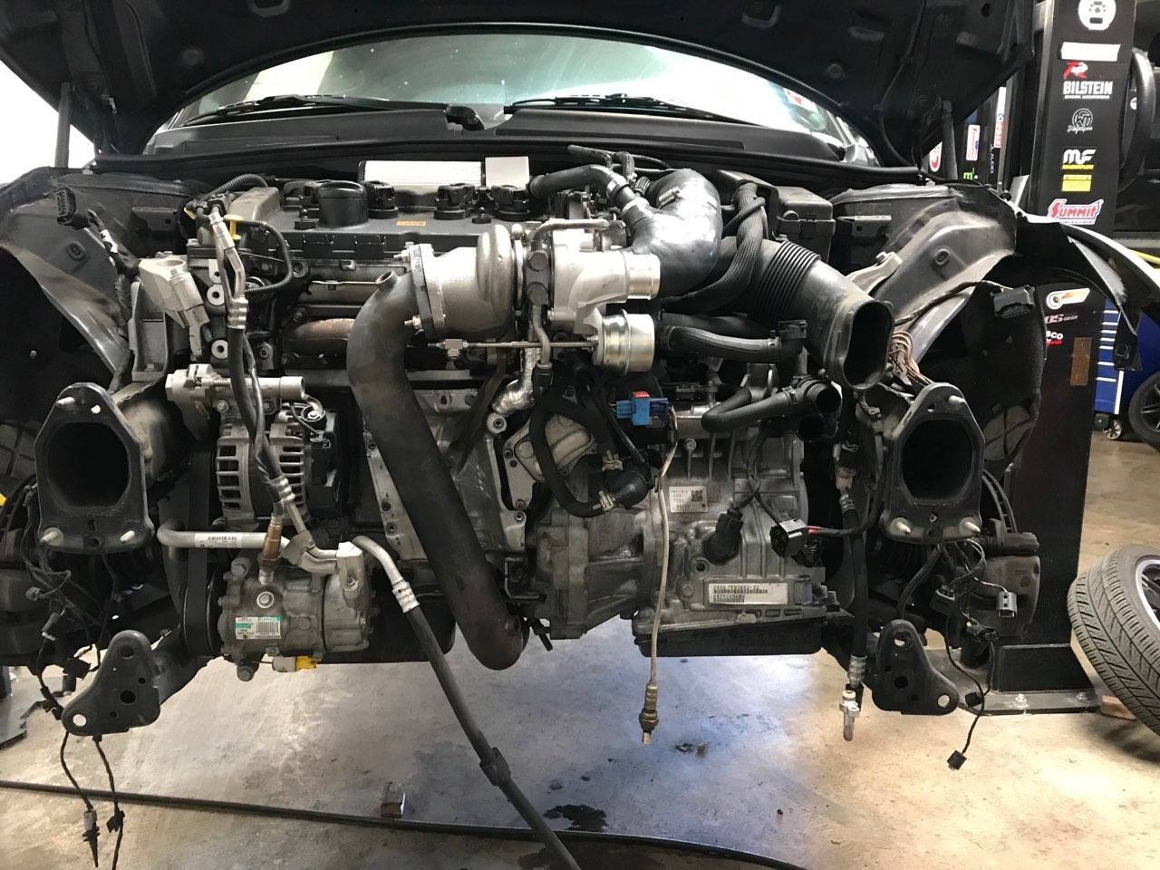

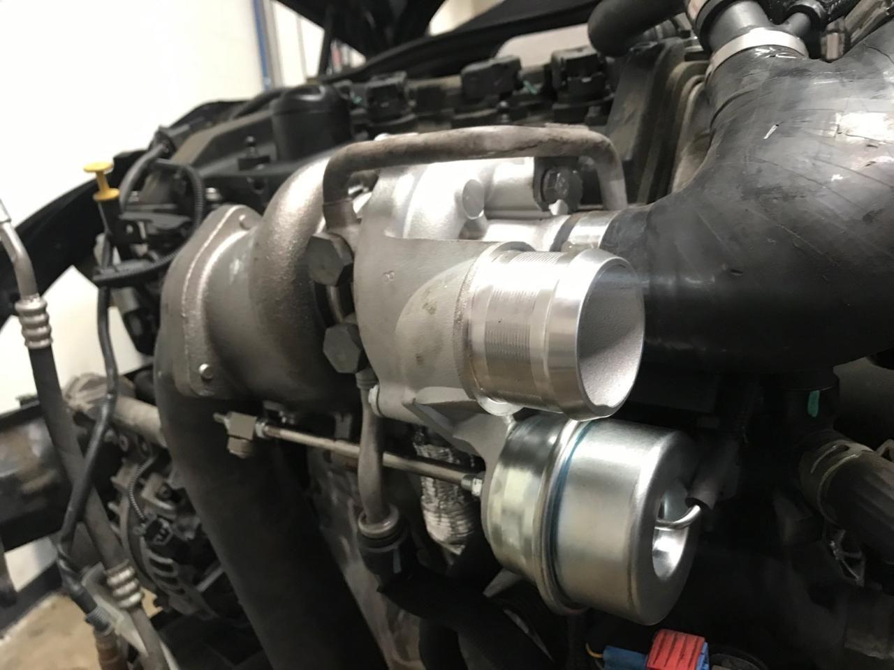

Well the car is in Mario's hands right now being worked on. Tonight or most likely tomorrow it will be done. Teared up a bit seeing my baby all taken apart. Atleast the downpipe and new turbo are installed now!
In my rush to get it over I forgot the friggin JCW Manifold!! However, i learned last night the N18s use a different manifold than the N14 and the JCW, i didnt know this when i bought the JCW manifold from Way. Summary thought being, JCW manifold will give maybe quicker spool but more top end power. I doubt i will ever really push it to 6k rpm as dd or canyon runner so i have no need now. My loss your gain, will be posting my unused manifold in the classifieds. The n18s manifold is apparently the lightest and has more flow so
