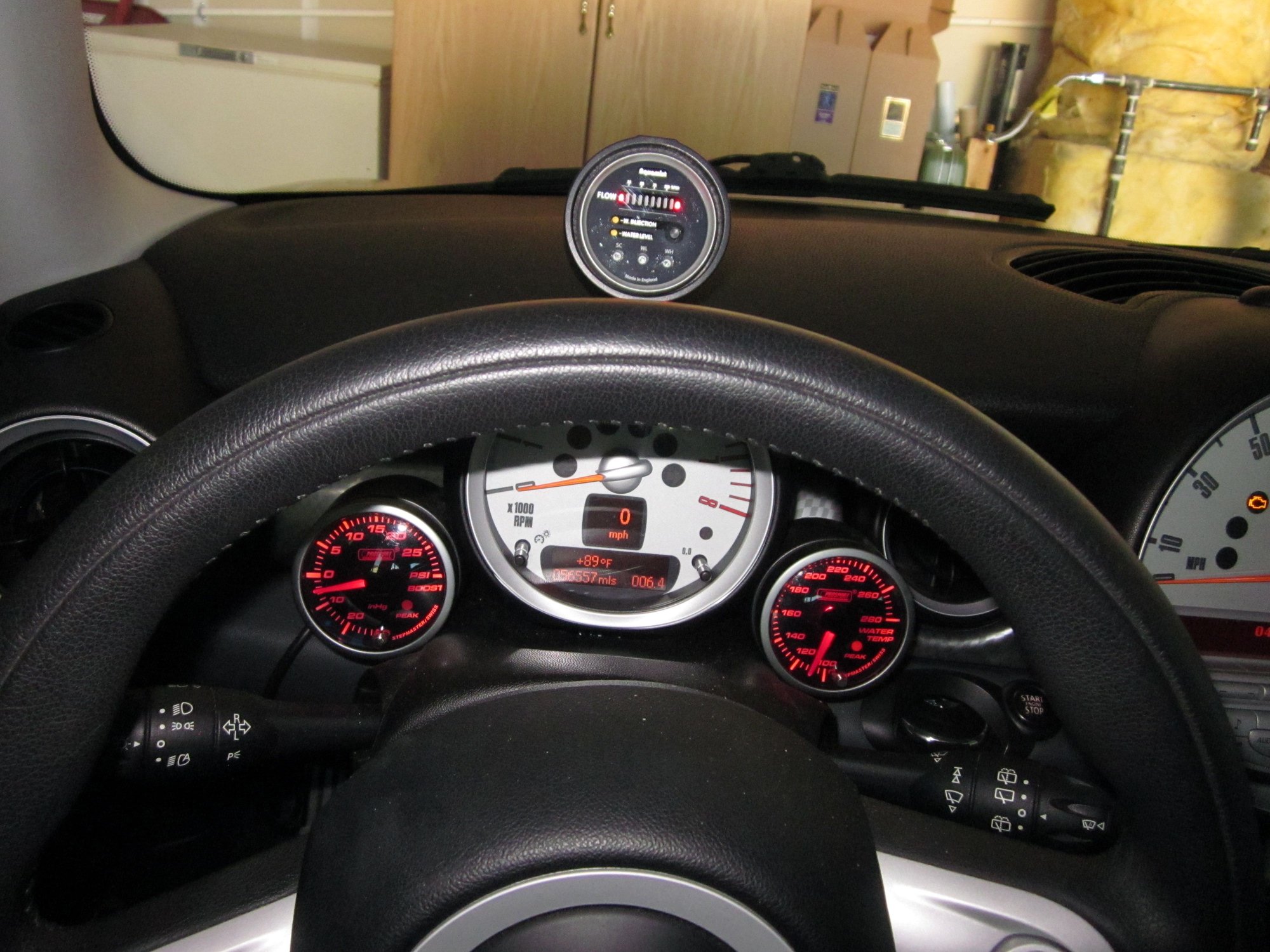

Old Sep 4, 2020 | 10:39 AM
  #135
Kupona's Avatar
Kupona
Joined: Jul 2017
Posts: 250
Likes: 43
That satisfying feeling getting all your boxes on the same day...
Okay so after some delays and getting some missing hardware (backplate and nuts) from CS, the cluster is built! The biggest POS was the nylon locking nuts. Also, I would have preferred having a physical install sheet for these products rather than try to navigate their webpages to find it in their install sections. They didnt have install instructions for some of the stuff I got too, but I figured it out.
I want to start off also with a special "F U" to the genius who decided the two T30 bolt holding the tachometer needed to be hard to reach and impossible to prevent from falling down into the plastic undertray around the wheel. Have it all asssembled, many adustments later it is looking great!
Small issue I had, the Tibia extension arm (top center arm) is not threaded like the bracket itself, despite Cravenspeed's webpage indicating both ends are threaded.
Here is my POV sitting inside. Two gauges on top will probably be Oil Pressure and Boost, bottom right will probably be air temperature.
Next I received the newest batch of strut bars from Racing Dynamic. Came well packaged! Pretty straight forward, bolted on and torqued to 20ft lbs. Went on a twisty run, probably placebo but swear i felt the front end was more solid going through turns. For $140 on sale, not bad at all!

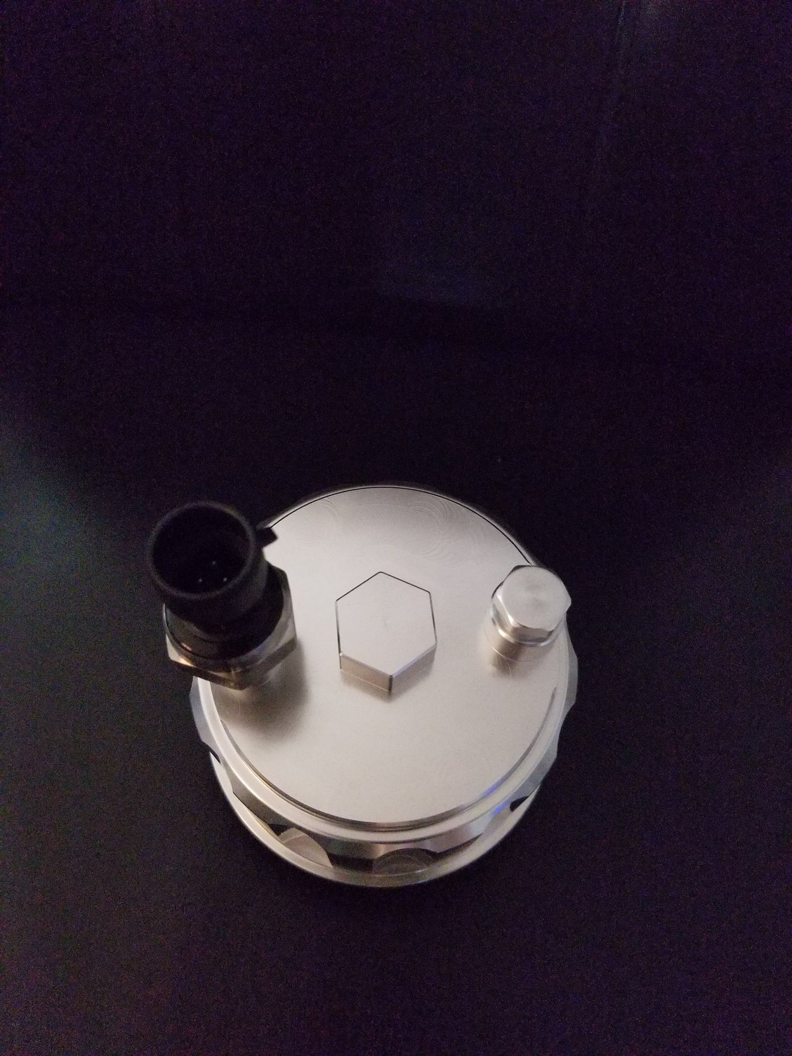

Alright folks, it finally arrived!! I present to you, the first Aluminum oil cap for our MINIs! Super impressed with the tooling and quality. Gasket sits nicely, 2 taps for oil pressure and temp, precise and quite sharp threads. Feels super solid. Credit goes to Merx Tuning out of Germany in addition to my man "Forge" (not associated with Forge the maker of intercoolers) on here.
Some notes to ensure proper operation: Do not roll gaskets on to the cap because the threads are super sharp and WILL rip it up. The sping+perch is universal and will fit any common MINI filter
Please contact "I_Forge_KC" on NAM or kcornett@podiumforge.com
Without further ado, photos!
This thing is too beautiful to mount..
Ingenius!! Magnet inside the spring which sits against the top of the filter head.

Looks nice! The only issue I have is the sensor locations... Every time you replace the filter, you’ll have to remove the sensors, or at least remove the wiring from them. Instead of have the sensors in the cap, a better place would be in the filter housing, so you wouldn’t have to remove them all the time.
Old Sep 15, 2020 | 03:09 PM
  #142
Kupona's Avatar
Kupona
Joined: Jul 2017
Posts: 250
Likes: 43
I will agree it is NOT PERFECT per say, but way better than the alternative which is more difficult. But to be honest, it seems a 2 second job to remove the cap and sensor wire due to...
Very easy to disconnect wiring when removing the cap. Oil pressure sender and wiring connect via waterproof connector
