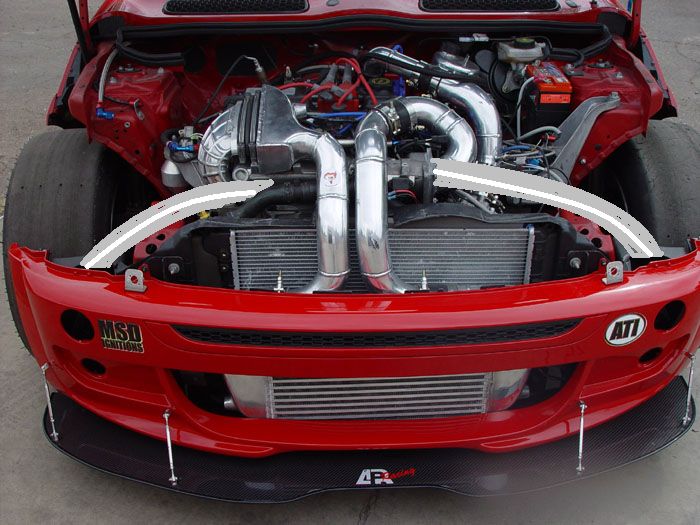

New FMIC!!! (though I doubt it's for sale)
Fireball Tim & Hubie Fuh Rock!
Just saw this image from the Fireball Tim Racing blog. Hope it's cool to have liberated it . Big up for such a great looking install & FMIC . Wonder how well it works (re: 90°+ bends etc.)? This Twincharged car must be an absolute MONSTER.

Wow! I gotta think it's time for a custom supercharger outlet. That could simplify the plumbing a lot, especially if the headlights are no longer needed.
Care to elaborate a bit more as to what/how you envision routing?
While the headlights aren't neccessary for such a crazy drag car the car they brought to HIN appears to have headlights (functional?). Have a look at the other images at the blog.
When I look at the insane car they built it appears as though it could be made into a complete sleeper. Probably only the exhaust (thier CRAZY setup) would give it away - visually speaking. Obviously the goal here was to build a statement vehicle which attracts attention & has go.
Obvious visual cues: FMIC visible through air dam, HUGE twin exhaust, lexan windows, wing, front splitter, being tubbed & shod with drag radials. Aside from that this MINI could look quite stock
Having lots of go without all the show does hold great appeal to me though.
PS
Any idea of what that orange thing is on top of, or where the ECU should be?

the orange thing is a battery
Hi minimute,
EDIT:
just zoomed the photo. It does look like a battery.
So, is this thing a Cooper - with Cooper S parts, or is it a super-heavily modified S? ...Cuz I've never seen a battery under the bonnet of an S.

I'm thinking something like this:
That way you could have fewer bends (basically just one big 180* on each side).
BTW, since it's a FWD drag car, it makes sense to relocate the battery from the trunk to the front for better weight on the front wheels.
