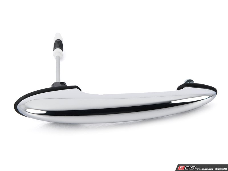

Nope, just NON CA and CA.
https://www.ecstuning.com/Search/Sit...h/51219800558/
Non CA has no rubber button
Comfort access has the button:
https://www.ecstuning.com/b-genuine-...t/51219801618/
