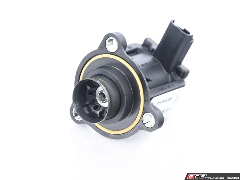

Factory DV valve is my bet, if you have a aftermarket spacer that vents to air on it, it will make that whooshy noise.

That's the latest one. 11658636606
https://www.northamericanmotoring.co...e-upgrade.html
Most people just change it out as they might have the older design anyway.

I don't think they electrically fail, there's a diaphragm that tears internally.
The original DV was problematic and it was replaced with to the revised version that ECS Tuning linked to. If yours is original and there's any question about it I would recommend just replacing it.
