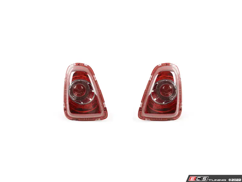

+1 thats what i was going to ask or maybe the footwell module is acting up. The FRM aka footwell module controls the lighting.
Does you lights look like this?
https://www.ecstuning.com/Search/Sit...h/63217255914/

@imrj you tagged your post as R56 but identified the vehicle as a 2015 Cooper S and posted in the F55/F56 forum. A 2015 Cooper S hardtop would indeed be an F55 or F56 rather than an R56. Sooooo... which one is it you've got?
If the taillights shown in @ECSTuning 's post above match, you have an R56 and an FRM as ECSTuning said, and your Cooper is not an F series.
If you have an F series, you do not have an FRM, you have a BDC, and the likelihood of specific scenarios changes (mainly because FRM scenarios get messy in specific ways really fast).
