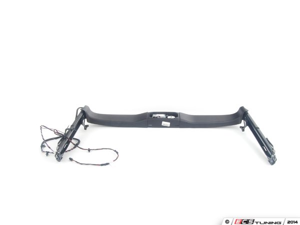

Sorry to hear your problem. Did you get a new cassette for the top ? I have heard of these becoming damaged when the sunroof cables set section sticks (breaks most of the way back ) , and then someone forces to put the top up by hand , nudge it, while the hydraulic motor tries to work. One side starts to go up and then twist the frame.
Convertible Sunroof Assembly / Top Box 54347180038
http://www.ecstuning.com/Search/SiteSearch/54347180038/
Hope you can get it working again. If you can replace that main section yourself, or at an indy shop who know convertibles on BMW / MINIs , they might be able to replace it.

Yea, we have the part linked above. If you know an indy place that does convertibles ( like the BMW new tops and hardtop ) out west, they could tackle this.
