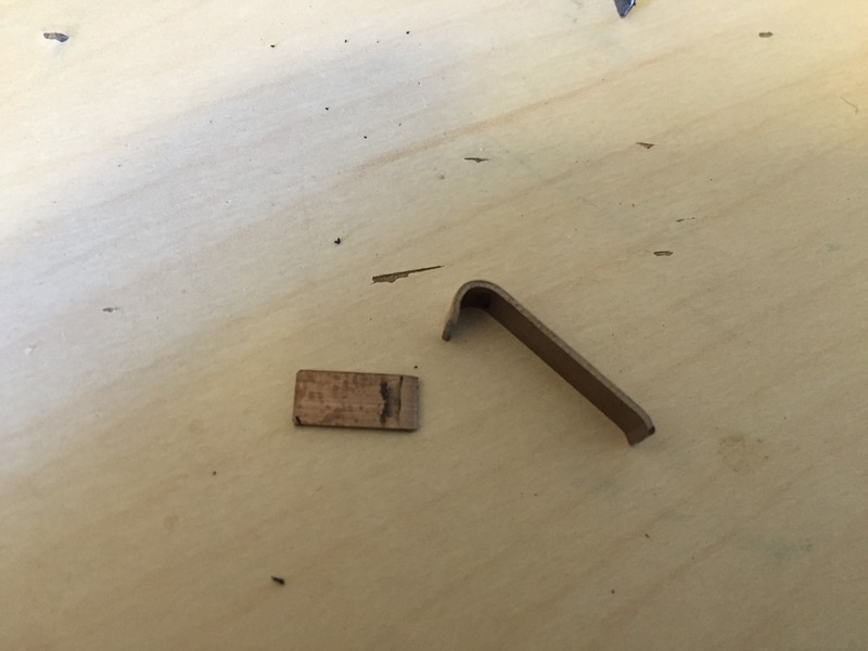

So then, on to the dissection. After staring this thing down for a good while, I realize that the "silver" lever is just a thin cosmetic cover. I carefully pried it off with a pocket flathead screwdriver & it popped right off, along with the two red rubber "S" inserts. Cool, now I'm left with basically the same thing, except now the lever is black, covered in residual glue & very ugly. Fortunately, this provided me access to a couple pressed-in pivot posts. I pressed them out by hand with a small allen wrench & ended up with this:
And the broken culprit!

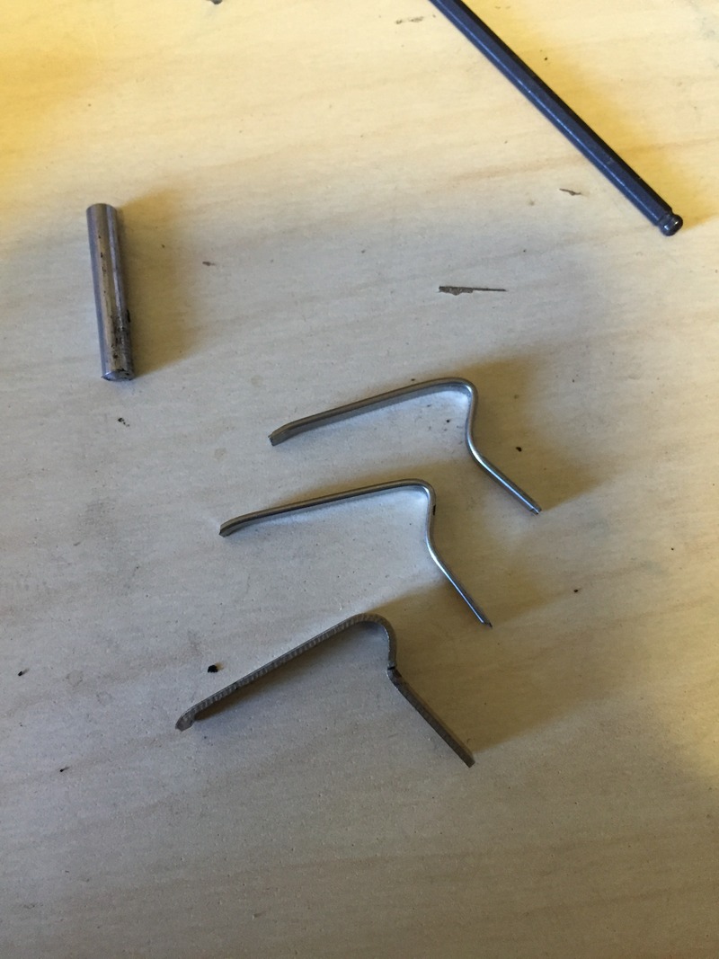

So now then, we've identified the broken spring. Let's replace it! Except.... it's made out of spring steel..... which is difficult to find, especially in a specific size. Well, after striking out at a few hardware stores, I did some searching around online. Someone that was trying to make springs for octopus puppet legs got the suggestion of "Why don't you use the metal inserts from a set of old wiper blades? Those are spring steel." HOLY CRAP, they were right! I went to my nearby O'reileys, grabbed a wiper blade out of the trash (because when have you ever been to an auto parts store that didn't have wiper blades overflowing out of the trash can outside??) and headed home to see if these steel strips would work.
Sure enough, not only were they the right gauge/thickness, but two of them side by side are the perfect width to replace the original spring! Awesome! Shaping them properly was a bit tedious, but I was able to get the job done with just a small crescent wrench and a pair of pliers, both out of an iKea tool kit haha.
Newly fabricated springs:
Now, reassembling the **** with all of its moving parts AND keeping the two new springs in place was the opposite of what I would call easy, but it can certainly be done! After about 30 minutes of wrestling the angles of the holes to get the pins back in, the **** was together & working. I re-attached the faux metal cover plate, along with the red S's with some super glue gel, which worked perfectly.

After finishing a bunch of other work on the car, I thought to myself "oh yeah, there's that damn broken gear selector spring situation". So, I get in & pull firmly up on the ****. Nothing. Another go? Nothing. I try twisting & knocking it around a bit, pull up as hard as I can & finally - POP! the whole thing let go & pulled straight out!
All in all, if you're crafty and have a good understanding of how mechanics work, this is a totally DIY-able repair, and all it cost me, really, was trip to a trash can to source a used wiper blade, and $3 for super glue!
