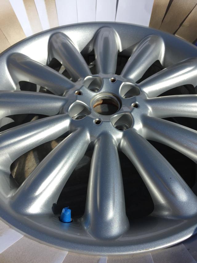

Here is the wheel uncleaned:
Cleaned:

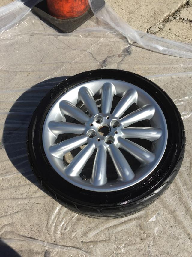

I dried the wheel thoroughly, popped the center cap out (I pushed it gently from the back side) and put a thick coat of tire shine on the tire.
I put index cards in between the tire & wheel.
And put masking tape around the valve stem making sure the tape didnt touch the wheel.

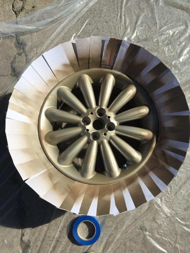

Here is the 1st coat. I held the can about 6-8" away and sprayed evenly with left to right motions keeping the spray on the entire time. (This was my second wheel which is why the index cards have a lot of paint on them)
I waited about 10-13 minutes in between coats, by coat 3 it looked great, however I still put 3 more coats on just to make sure that it peels off easily as I know I will be removing it down the road.

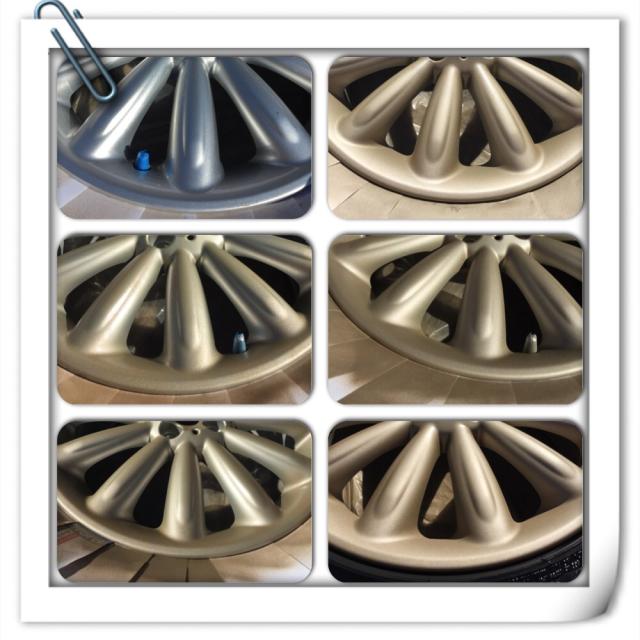

Here is a snap of each coat:
And Here is the comparison of the silver versus gold:
Cleaned:
