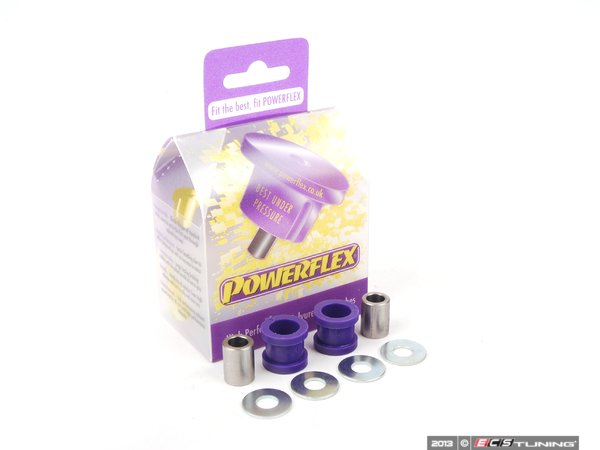

We have the Belt Tensioner here; Part # 11288620210 newest. And the powerflex version bushing are there also at the bottom as a replacement for the stock rubber bushings on the strut.
