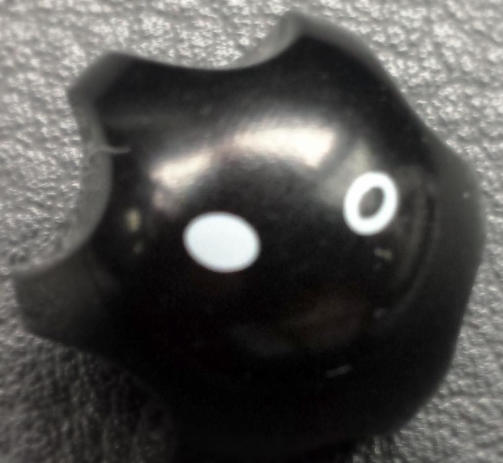

2. One of a vent's little rotating valves (the part that regulates the airflow of a single vent) has fallen off. How do I get it back on?

2. Think its works it way back on from side to side, do you have a pic?

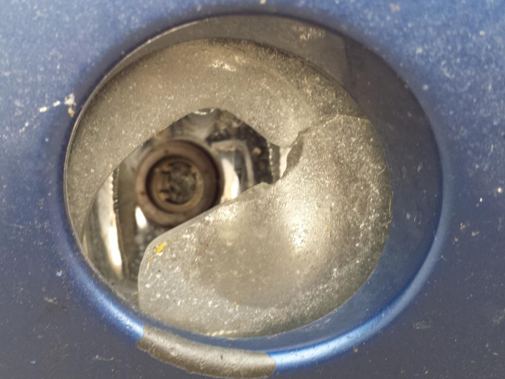

Thank you for all of the information, ECS! I will take a photo of the vent cap in a mo'. I will also post a picture of the fog lamp for further clarification. I will be glad to replace the bulb, but I also need to replace the glass lens that covers the lamp. Also, the DRL glass is cracked. Can I buy just these glass pieces? I will grab my mobile and get some pictures.

Photo from top to bottom:
#1 for the vent **** and is part of the the vent adjuster. There are four of these total on the dash. Part # 64226800887

Photo #4 The fog light on the passnger side.
You might have the original as from above"
If you have the early production fog lights and they have not been replaced with newer : 6/2002 was the year split. Pre 6/2002 with the original fog light housings have the H7 bulb. Post 6/2002 have the H11 bulbs. Check the production date on the door jam
Picture of the newer 6/2002+ housing: Its twist and pull also but with the larger H11 bulb. Sometimes the corrosion and age makes them a little hard to come out. ""
The glass is broken and you cannot just replace the glass it the whole housing. You will have to change it out to the H11 set up if you are pre 6/2002 , if it has been changed or you are posrt 6/2002 . They its just a quick change out. Looks like they have had better days, I would replace the other side the match also.
