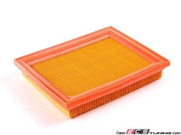

Square Filter:
Or follow the OEM Part # 13721477840
http://www.ecstuning.com/Search/SiteSearch/13721477840/
There is also cold climate version of these filters: 13727520855 , they have a little foam attached filter in front of the main filter.
http://www.ecstuning.com/Search/SiteSearch/13727520855/

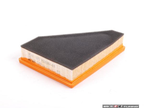

Triangular filter:
Or follow the OEM Part # 13727529261
http://www.ecstuning.com/Search/SiteSearch/13727529261/
There is also cold climate version of these filters: 13727529264 , they have a little foam attached filter in front of the main filter.
http://www.ecstuning.com/Search/SiteSearch/13727529264/

Square Filter:
Triangular filter:
[QUOTE=jwh;3955299]The air filter element in my 03 R50 is rectangular like this:
Yeah, that's what mine looks like, too. But when I take the element out, there are some protrusions into the air box underneath in what would be the top right corner in the picture, so I can see how the angled filters would fit that shape, and possibly just fit lower in the box?
The Mann filter website online catalog specifies the angled filter for a '04 with a manual transmission, and the rectangular one for the automatic transmission. This is in line with some comments I read on Amazon that say the same thing. However, when I've purchased filters over-the-counter at car parts stores, they always seem to hand me a rectangular element like the one in jwh's picture.
Are there two different kinds of transmissions (Getrag and ???) that shipped on the '04 justas? Does that make a difference?

The link to the Pipercross explains the transmissions and year split and the shapes. Also I have linked all the other filters to help. Thanks. ::Thumbsup::
