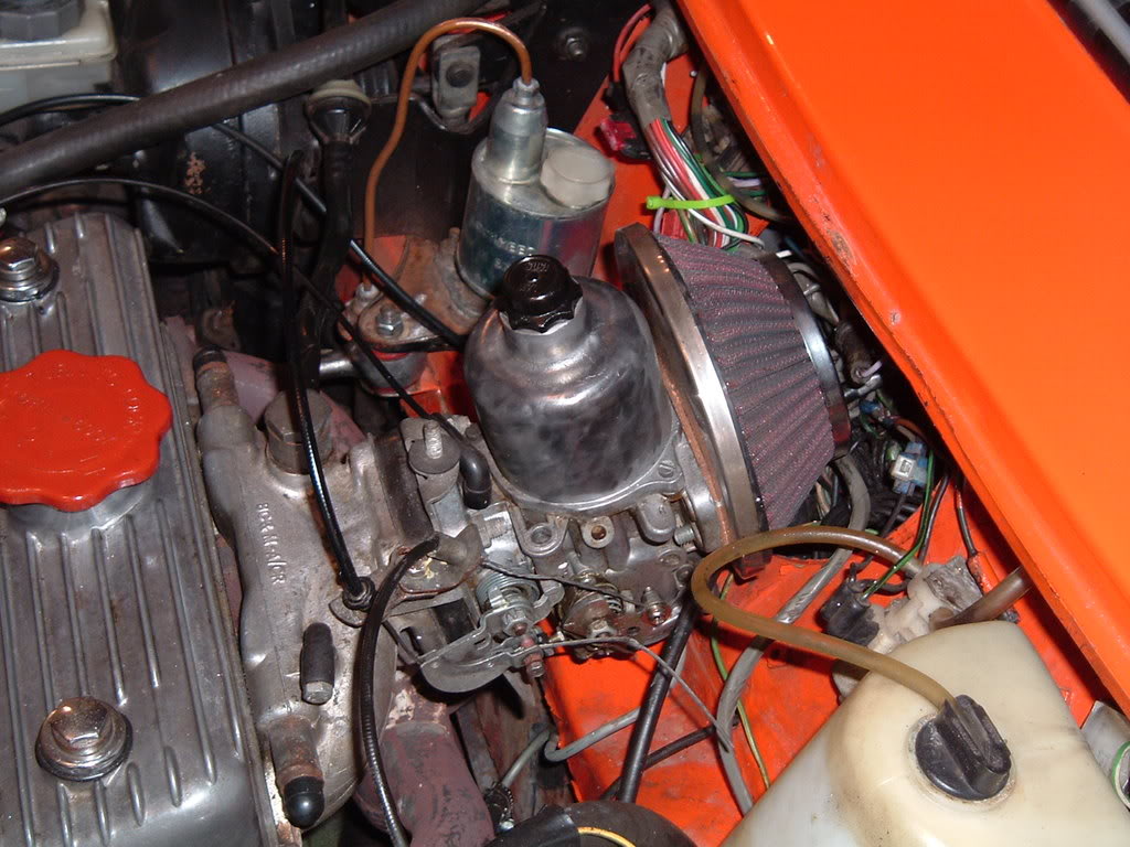

BTW do you want one that repairs MINI or Mini?
To some of us there is a BIG difference. I doubt many MINI mech's have ever SEEN an SU carb!
My MINI and my Mini (a few years back)

I hate carburetors, my brother has to change the jets every time the weather changes on his fully restored Honda Z50 (bored out to 75cc).

question .. how do you tune an SU?
there is only ONE correct answer and I have dozens of references to support . . . .
1) disconnect the throttle linkage.... skip for the mini...
2) set the idle to about 1K by screwing in the idle screw... repeat as needed
3) check mixture by lifting the piston about 1/32 - engine speed increases significantly - too rich - weaken mixture by rotating mixture nut counterclockwise - if speed decreases - mixture too lean - rotate mixture nut opposite direction - if speed slightly increases... just about right
4) repeat 1-3 until perfect
God I miss those old carbs sometimes!
