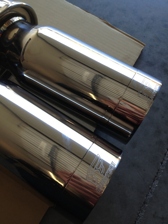

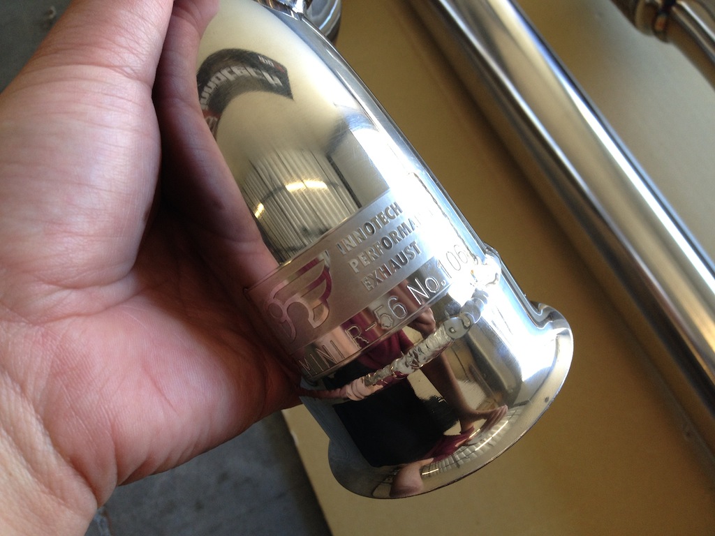

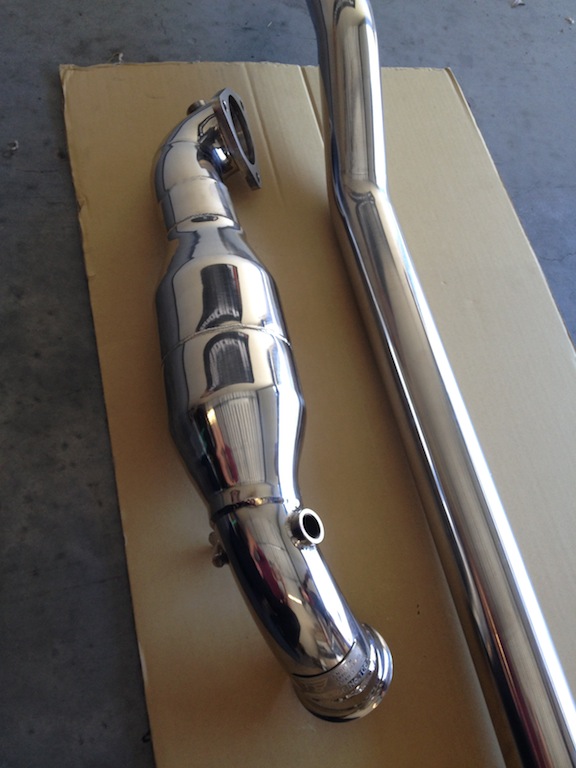

As some of you know, I have a build thread circulating, but I wanted to take a moment to reach out and let members know of a new system that hasn't seen the light of day until I became the first member forum, or no forum, to get this system installed. iPE Innotech. The Taiwanese company is synonymous to exotics. Their systems have been on Lambos, Ferraris, McLarens, and now a MINI.
I was intrigued with the system because of its valvetronic capabilities and also the simple fact that no one has ever heard it in person, not even any sound clips anywhere! I try to be different and think outside the box and I'm not afraid to spend on quality parts, so when I spoke to iPE, the conversation led me to Lance and Vince @ GT Auto Concepts. These guys are great. They are also known as DuelL AG North America and having seen their DuelL AG MINI in person, I was impressed with DuelL's quality and the shops interest in the Asian market for Euro cars.
Drove up to SF from LA on Wednesday morning at around 2:30am and came home the same night at midnight. It was a long tiring day/drive, but The guys there took care of me, they were equally impressed with the quality of the system and the intoxicating sound that it bellows in it's On and Off modes.
The system comes with 2 remotes. Each remote has an ON, OFF, and AUTO mode. While in On mode, the system is brutal. It sounds amazing! I had Akrapovic before, and this just blows it out of the waters. It's not obnoxious which was something I was afraid of since I've never seen or heard the system, but when it was first tired up and rev'd, I knew I hit the jackpot, this was IT. The system to beat.
In OFF mode, the system is subtle, your wife/gf/significant other will love you, she will compliement the smart choice of having it off for her while you're driving her around town, but the MINI she's gone, ON it goes and you're wailing along in the city with everyone looking at you. It's so smooth that you want to rev the crap out of it and with the bit of low end torque lost, what you gain up top from the catless downpipe, is a dream.
In AUTO mode, Vince set the system to activate from OFF to ON at 4000 RPM. So when it reaches 4K, it immediately opens the valves and the deep note from the system can be heard. It's such a smooth transition and you'll notice the visceral sound different and power immediately.
Easily one of the most expensive systems out there. It will make you turn 180 quickly, but it will reward you if you don't. Keep in mind, like any downpipe for the R5x generation, a O2 sensor CEL will come up. It happened to me 150miles into the drive back down to LA. An easy fix to this would be either running an AP if you have the tune, or getting the BMS CAN Tool which can deactivate the light.
I'm the first in the US with this system, and I hope I'm not the last. If you guys need a reference before you speak to Lance or Vince at GT Auto Concept just let me know and I can have them contact you.

Interesting. Can you explain the relationship of the electronic device in the pictures to the exhaust?
I am not familiar with this company. The pipes look nice but I don't see how the device interfaces into them. Or does it? How does an electronic box turn the sound on or off?

The electronic box acts just like an Aquamist meth kit. It requires tapping into the ECU and running the cable back into the vehicle where I have the box hidden under my carpet on the passenger side. A bit of wiring also runs from the back of the system where the valve opens and closes. For those that have tackled the Aquamist install, it's straight forward and the diagram for the install is easy. GT Auto Concepts documented the install and I didn't have to do it, but there's absolutely no doubt that I could have done it myself. Because I'm the only person with an iPE for the MINI platform, iPE Taiwan needed the footage. So iPE will make a proper video when they finished the editing.

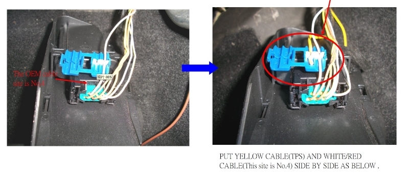

Need some help with the wiring. I have no idea where the TPS connector is. The instructions are terrible
^I need to find that.
And also where do i route one of the wires through the firewall?
This whole installation is giving me a headache. Help please!

You need to remove the pedal. That is a photo of the connection on the inside/back of the pedal.
To get through the firewall you need to follow instructions on routing wires for a boost/temp guage. There are two places, one by the battery and one on the drivers side. It requires you remove the wiper blades and cowling covering the area.
This thread has a couple photos https://www.northamericanmotoring.co...ary-power.html
here is a good thread - https://www.northamericanmotoring.co...ml#post3540666
