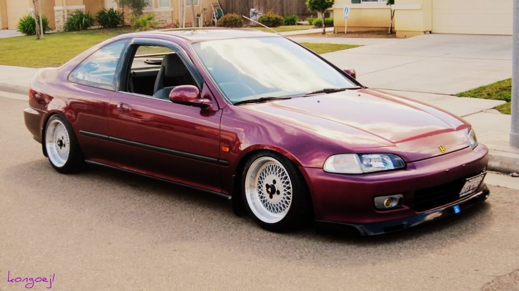

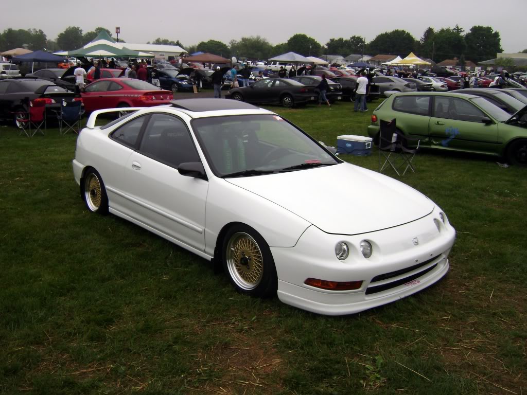

15x8 et 25
15x7 et 38
A lowered suspension gives you less room for clearance on a taller or wider than OEM tire.
A wide rim with an aggressive offset will stick out much farther than OEM so when you put a wide tire on that rim and you lower your suspension you risk rubbing the top outer edge of the tire against the inner upper plastic fender arch.

An example of a Konig Flatout 15x8" wheel with et25 and 225/50-15 tires on a lowered suspension (1.5"). Front camber -3.0 degrees using adjustable front camber plates and rear camber -1.5 degrees.

[QUOTE838]Tires don't have lips, rims do. When using a rim with a larger lip it refers to the distance from the outer rim edge to the start of the spoke area that leads to the hub.
Using a 15x8" rim requires usually a wider than stock tire, from 225m or wider is possible but the wider the tire the less clearance you have and more risk of rubbing especially under load or over uneven surfaces.
When the road has potholes you want tires that have a taller sidewall like 55 or 60 series not 45 series which is very short and stiff, it rides very firmly over bumps and is too jarring for some owners.
An example of a Konig Flatout 15x8" wheel with et25 and 225/50-15 tires on a lowered suspension (1.5"). Front camber -3.0 degrees using adjustable front camber plates and rear camber -1.5 degrees.[/QUOTE]
Hey Thanks For The Pictures, I Wasn't Sure If 15'S Would Fit An R53 , Are You Running Springs Or Coil Overs To Lower YouR Suspension? So You Think ThE Enkei92 Will Fit?
R53 came with either 16" or 17" wheels OEM but will fit 15" to 18" MINI wheels as well. Problem was with the large JCW front brake calipers which did not allow for any OEM 15" wheels.
The pictures are of a sample MINI using 15x8 et25 wheels not my own MINI.
I have a 2003 R53 with Bilstein PSS9 coilovers and have run wheels from 15" to 17" in widths from 5.5" to 8" wide and many tire sizes.
The Enkei 92 in 15x8" will fit if you plan accordingly. The more you can adjust the suspension the better to allow for clearance. Full ride height adjustable coilovers would be better than just lowering springs, you can fine tune your drop to get the clearance you need. You may also need adjustable front camber plates to increase front negative camber which is the tilt inward of the front tire so it doesn't rub against the fender arch.
