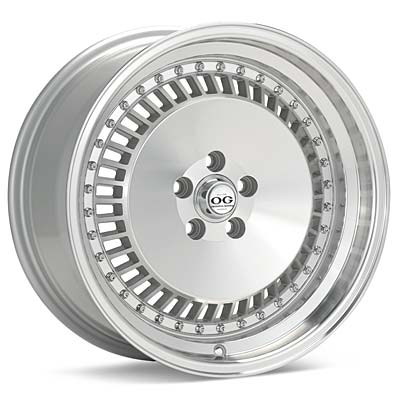

I want to buy the axis og Europa wheels they are 17x8 et25 I'm not sure it the offset will fit?

What suspension are you running? Any plans to lower it?
Assuming you have stock suspension, compared to 17x7" wheels with stock 205/45-17 tires-
The OG Europa wheel in 17x8" et 25mm will stick out 38mm or 1.5" which is too far for the stock fenders, adding wide fender arches is possible, or you can use a narrow tire and stretch fit the wide wheel for at look. A 205/45-17 would work.
There is room for clearance on the inside from the brakes and suspension.
If you have coilovers with ride height adjustable then you can consider many tire sizes, just lower the car to get clearance.
215/40-17 would fit the wheel and give you more clearance from rubbing the rear wheel arch.
235/40-17 is a good fit but tire selection is a little limited, Dunlop Direzza ZII is very good.
245/40-17 and 215/45-17 are also workable sizes but run a little taller than OEM but can work with stock suspension. This gives you many more tires to choose from.
What sort of goal do you have for wheels and tires?
Are you going for a certain look?
Did you have any tires you wanted to consider?
What about budget for tires? Suspension, etc?
Clubman with OG Europa wheels, tire is slightly more narrow, suspension is dropped

I was just going I get h an r lowering springs that's about it... If these don't work can I get 17x8 with et of 35 to fit?

As you can see with the example picture above you can get 17x8" et25 wheels to look OK but-
You may need to customize the suspension drop by upgrading to fully ride height adjustable Coilovers (expensive usually), adding front adjustable camber plates and rear adjustable lower control arms to gain more negative camber as needed to fine tune the position of the top of the tire and tilt it in a bit for clearance. And you may use a tire size that allows for more clearance and a tapered look once mounted so that it fits the wheel arch.
If you have only lowering springs you drop a certain amount and that's it. Also remember that tires with a lower sidewall will be stiff riding and jarring on anything but smooth roads.
With a drop in suspension you may want to avoid 215/45-17 or 245/40-17 since they are both 24.7" vs 24.3" for OEM.
Changing from an offset of 25mm to 35mm means you are moving the wheels less outward by 10mm. So it would stick out 28mm or about 1" further than stock. This is not bad and should be OK, just select the right tire.

Alright just so I know I'm understand I can fit a 17x8 et35 without getting camber plates And all that I just want the lowering springs but I can get 17x8 et to fit if I stretched the tires or got camber plates and coilovers? I am also looking at the esm 001 wheel as well which one would be better for me if I just want to get lowering springs?
Assuming you don't want to risk rubbing.
The more adjustable the suspension the better.
Ride height
more negative camber front or rear
Tire size that is no taller than OEM 24.3" and not overly wide but does not need to be small and stretched. A perfect fit would work.
H&R lowering springs usually decrease ride height by-
1" in front
0.75" in the rear
Some examples of tire sizes on a 17x8" rim.
205/45-17 tire
215/40-17 tire
Some tires stretch better than others.
235/40-17 would look like this on a 17x8 wheel
Old May 19, 2013 | 04:03 PM
