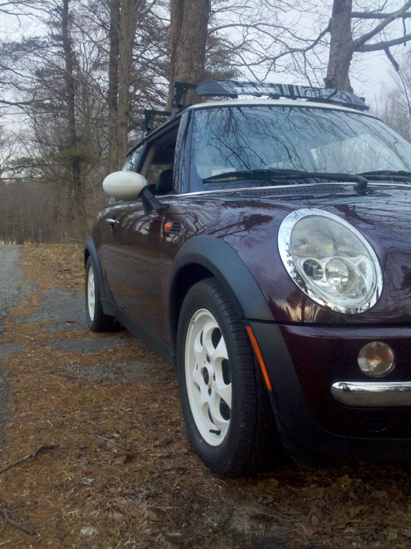

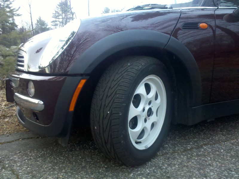

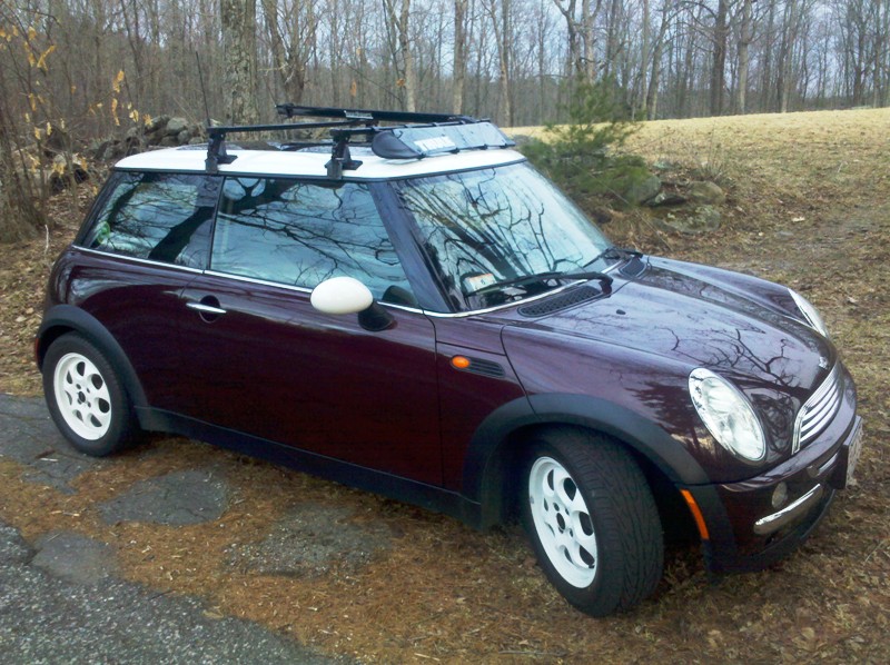

I'm starting to like these tires. They are heavier, but roll very smoothly and are very stable at speed. I took a few pictures today with my phone. I'll take better ones when the light is better. But for now:

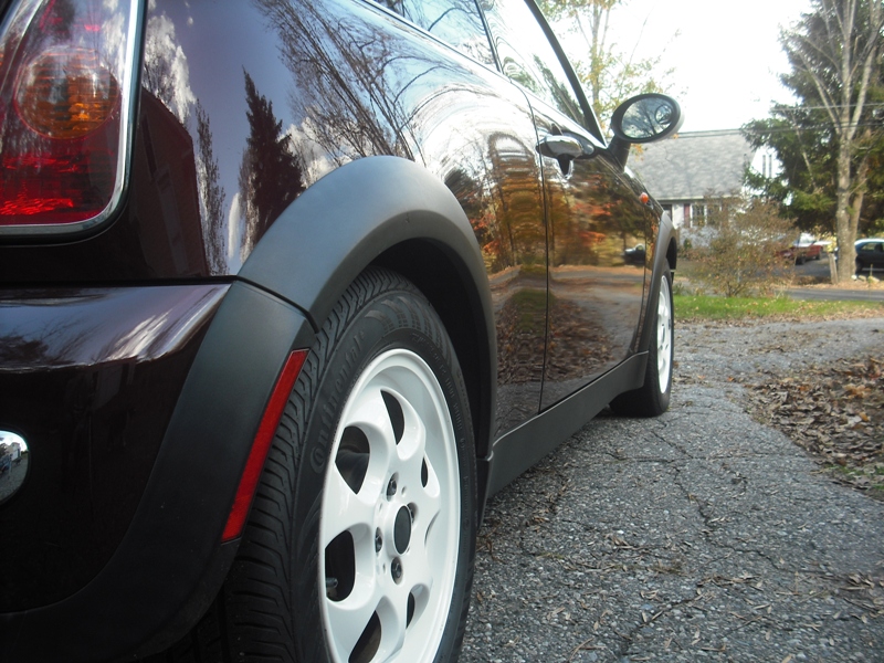

Last autumn's stock Contis:

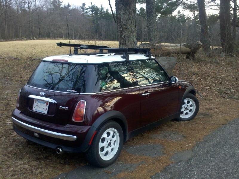

..and now with the 205's...

They look great and I like the color combination overall. I too felt the same thing as you. A little slower at first then a feeling of stability and smoothness. It corners alot better too.

Thanks for the kind words. Yeh, they are really growing on me! The stance too.
