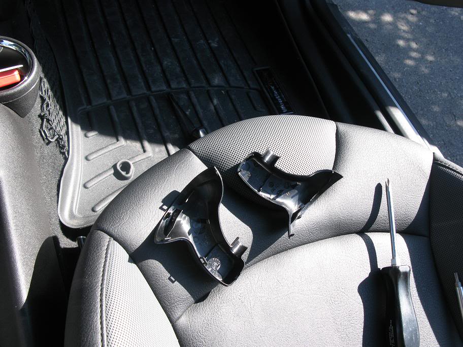

2. Remove the driver’s side sunvisor and the passenger holy poop handle, all torxName:  rearhandbar.jpg

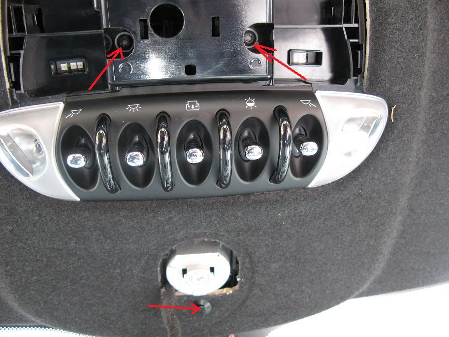

3. Ahead of all the switches overhead, remove the cover, it just pops off and remove the torx screws and the plastic clip, see red arrows

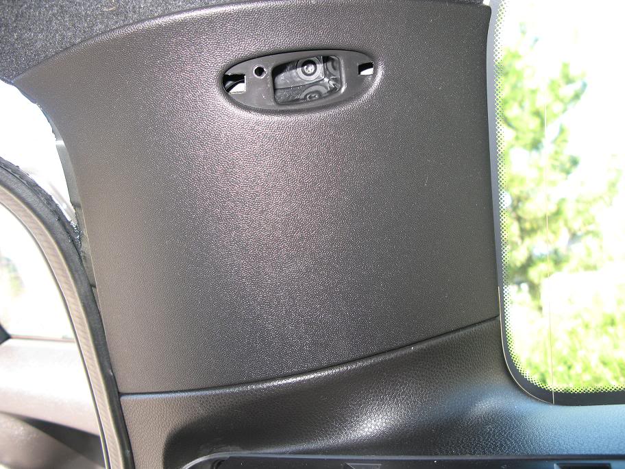

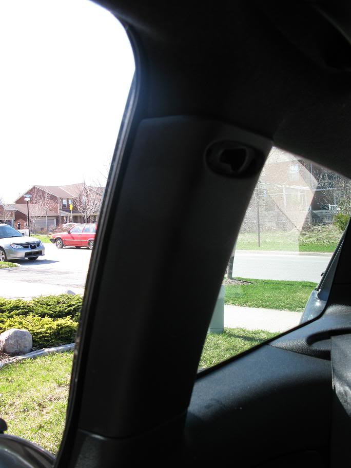

6. Next you have to remove all of the side pillar covers. Two pillar at the front, two at the side and two in the rear. There is a screw behind each airbag symbol. These just pop out and there is a torx behind

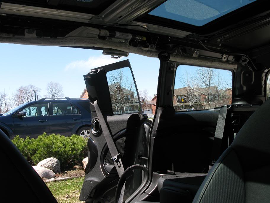

7. Pull down the weatherstripping around both doors and rear doors. There is one plastic plug in the center of the headliner in the rear

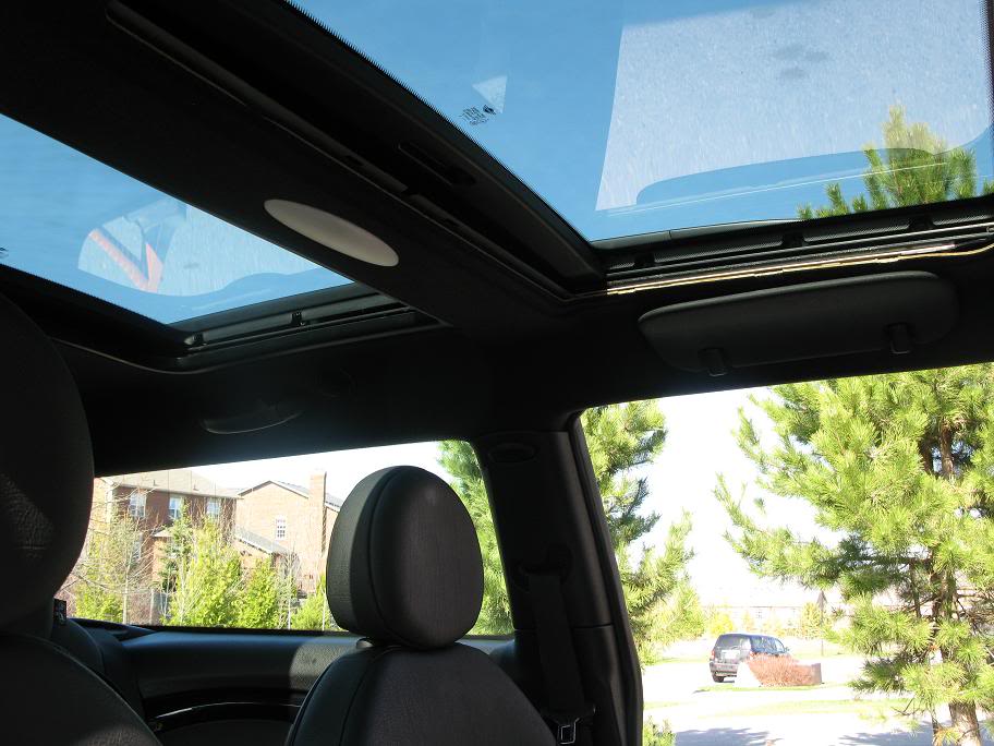

8. Lastly there are the sunroof surround trims. These are what hold up the headliner so once you remove these the headliner will drop. Start at the sides, pull them in. Then you have to twist either the front or back. There are two points where these clip, and they’re a bugger to remove.....but even worst to get back in..grrrrr.

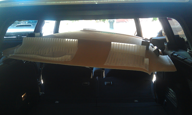

10. Now remove the headliner. To help, take out the front headrests, no need to pull the seats. Be thankful for the third door, it comes out easier than what you would think. Here are all the pieces removed

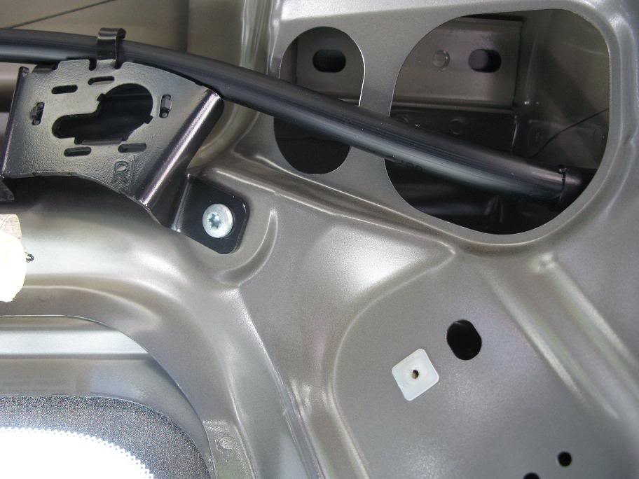

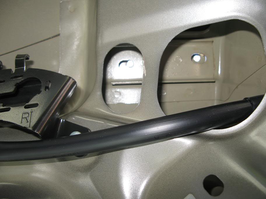

11. There is no template for this. The best way is to use the holes from the inside to guide you. This is the front, middle and rear

12. Here’s a shot of the side airbag. You drill nowhere near this so don’t worry about it

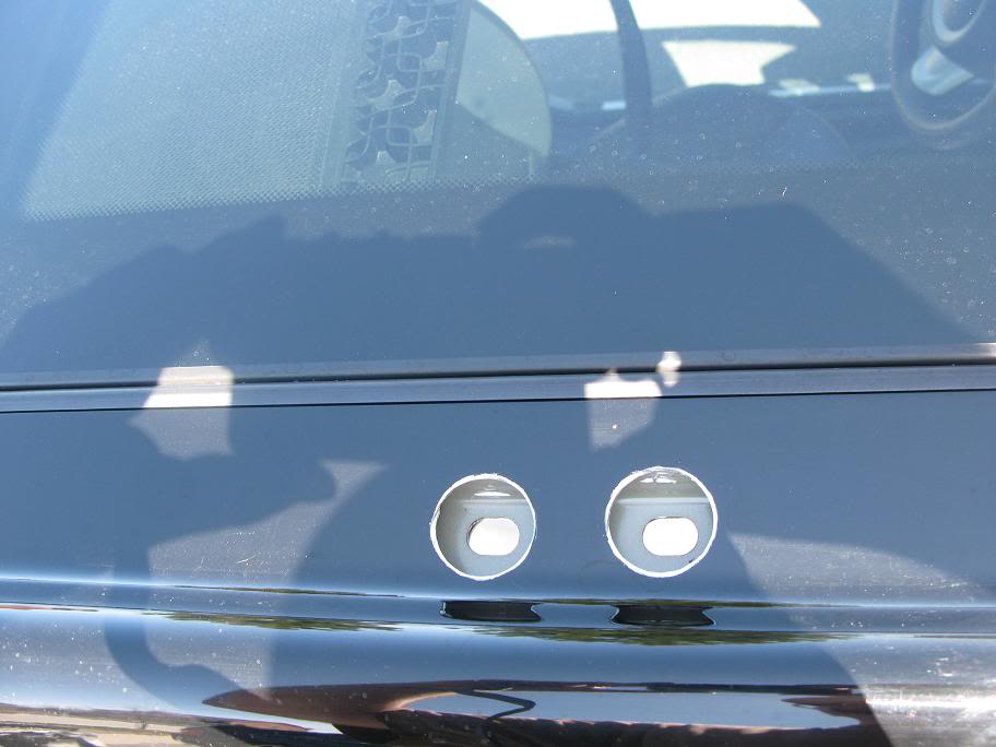

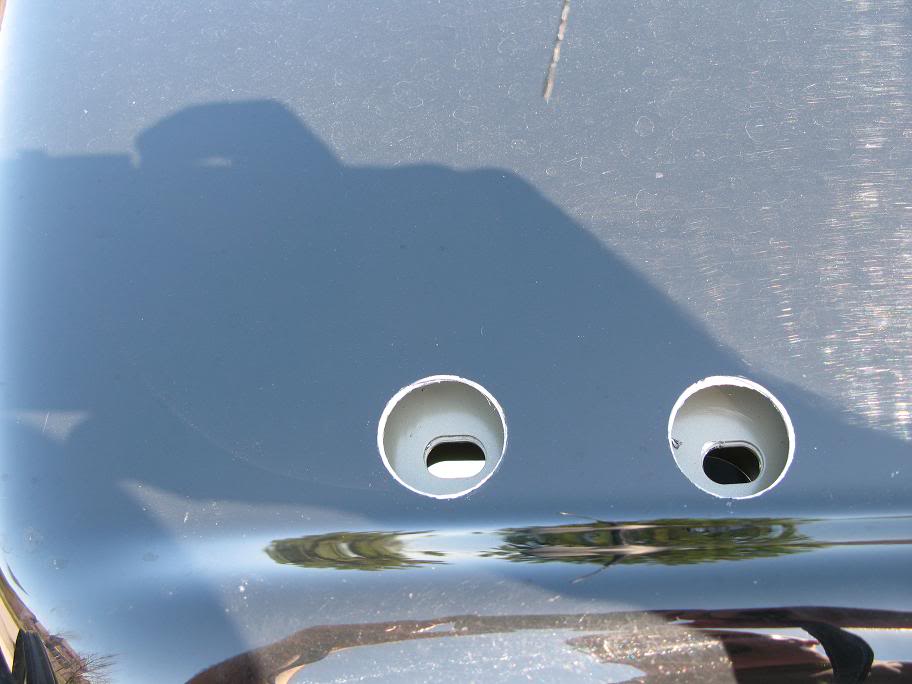

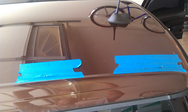

14. Tape off near the holes on the roof. I used a 1-1/8 hole saw. Because you don’t want to enlarge the mounting holes I wouldn’t recommend a stepper bit. This size of hole saw just gives a little more wiggle room. Here’s the front, middle and rear. I then painted all bare metal to avoid rust

15. I was going to silicone the roof rails, but after looking them, I decided against it. There are two rubber seals and some closed cell foam

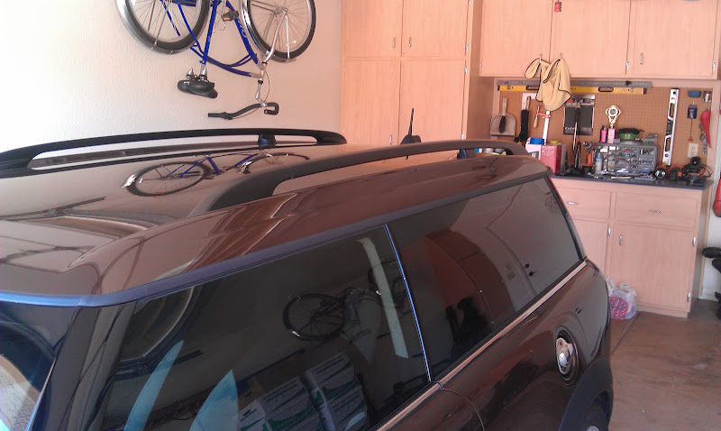

The results...

Drilling from the inside out pretty much makes it dummy proof. When using the holesaw make sure you have about and inch of the drill bit sticking out. That way it will limit the chances of the hole saw getting away on you. It wondered a bit on me on one of the rear holes, but the rail's feet area is big enough that even with a bit of error no one will see.
