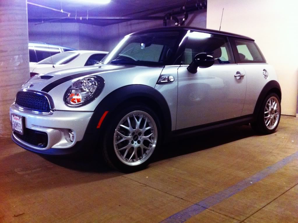

Here are some pics. I am still on OEM springs so there is a wheel gap.
BBS R90's wrapped in Hankook Ventus V12 evo K110 205/45/17

Old Jan 26, 2011 | 08:14 PM
Blainestang's Avatar
Blainestang
Posts: 1,478
Likes: 59
Very nice MINI. The White Silver is really a cool color.
So, the '11 TPMS worked on the R90's without any problems?

Yup! No problems at all!
