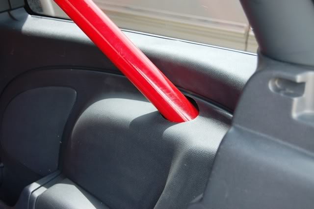

Recent install of an Autopower Street-Sport roll bar.
Turned out very clean. Working on a rear seat delete currently.

Have any pics of mounting points before panels were installed.

I'd put a bit of black trim around the opening for a more pro, clean-looking install, but other than that VERY tasty...

I've thought about adding trim. Hole would need to be enlarged a bit but we'll see. I don't have pictures of the mounting points. I will take some the next time I have access to that area. Ditched the bolt / nut method. Used high strength nutserts and bolted from the outside in with no need to hold a nut in place.

If that is how clean an install you can do on a bar, when I am ready for my install you get the job . Nice and clean.

How hard was it to make it that clean? That looks amazing.

Thanks for the good words. It really is not an easy job but where there's a will there's a way right? Requires a good amount of patience. Cardboard tubing cut to length served to mark the exact location of the holes to be cut. Tolerances are so tight on the bar so you must align both panels and insert the side bars simultaneously.
The end result is worth the added aggravation in my opinion as I really did not want to go about it with the slit method.

Best roll bar install I have seen. COR BLIMEYS is good but this is even cleaner.
