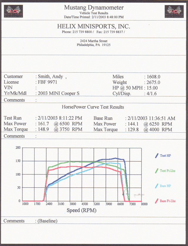

That's whp. In that test, the baseline was Helix/P&D 15% Pulley, MTH chip. The Test added the Magnaflow exhaust. No other changes. Same dyno, same day, same car.
Here's a stock baseline compared with Helix/P&D 15% Pulley, MTH chip.
There's a 2whp difference between the two Helix/P&D 15% Pulley, MTH chip runs, but they were done a few weeks apart.

you hp monkeys need to look more at the shape and magnitude of the torque curve to assess results. A small upward blip at high rpm can give a misleading high hp; a high torque reading at lower rpms will not necessarily give a large max hp number, but will develop very desireable performance.
