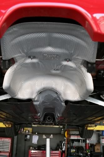

Well, here are the pics starting with the stock exhaust...............Name:  R56Quicksilver13.jpg

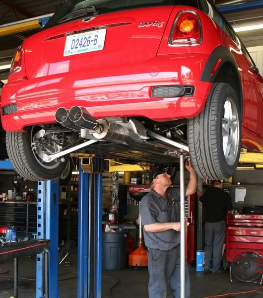

Here is the installer cutting off between the resonator and the 2nd cat..........Name:  R56Quicksilver11.jpg

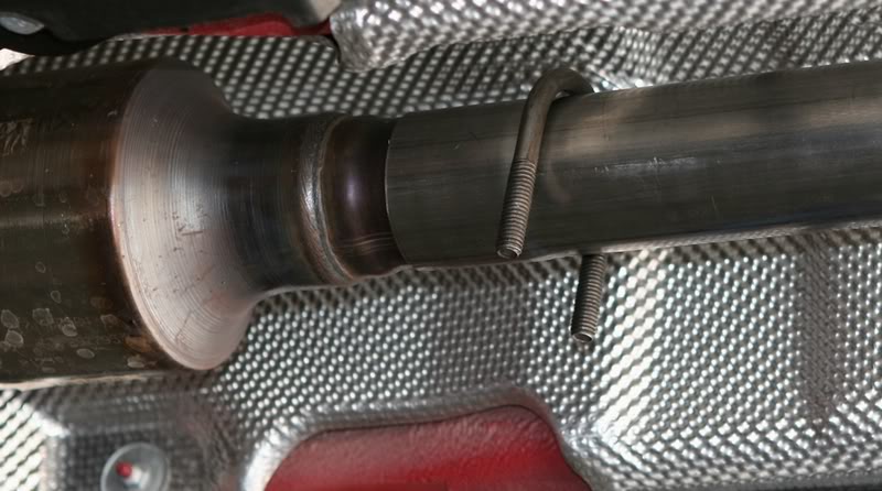

Here is a pic showing how the Quicksilver was mated to the stock exhaust, basically slipping the Quicksilver pipe over the OEM pipe. I opted to not have it welded since the clamps used are perfectly sufficient and this will allow for an easy swap out later on if I sell the car.

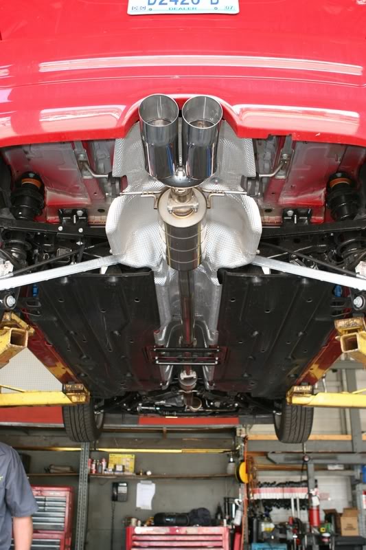

Straight shot with everything being buttoned up.................
And, last but not least, the tips fit absolutely flawless. Thumbs up to Quicksilver on the flawless design!!!
