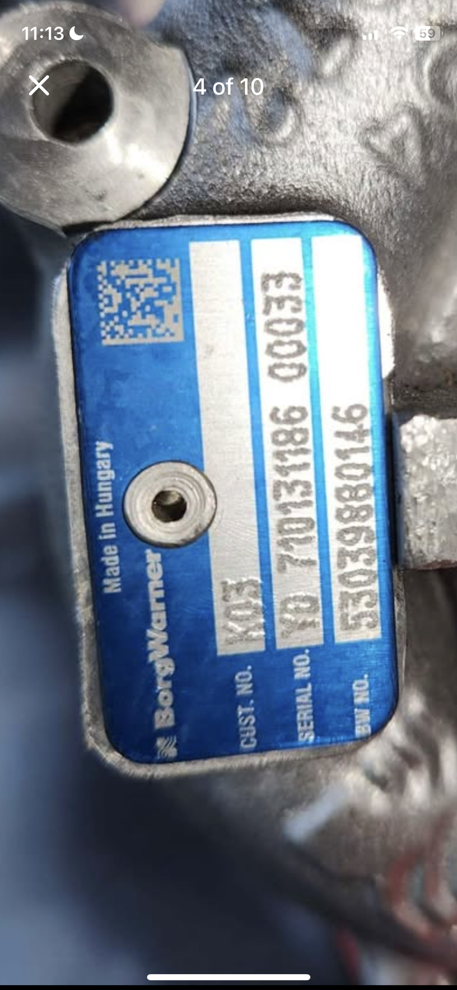

Apologies in advance if this has been asked over and over but just not sure hoping y’all can help?
53039880146
because it’s my understanding these are the JCW part numbers with 0298?

The -146 turbo is the OEM N14 JCW turbo, the -298 is the OEM N18 JCW turbo. There were slight improvements made to the N18 version, which facilitated a new part number. You will get slightly better performance from the -298 version, but not much. Either will be a performance improvement over the OEM Cooper S turbo.
