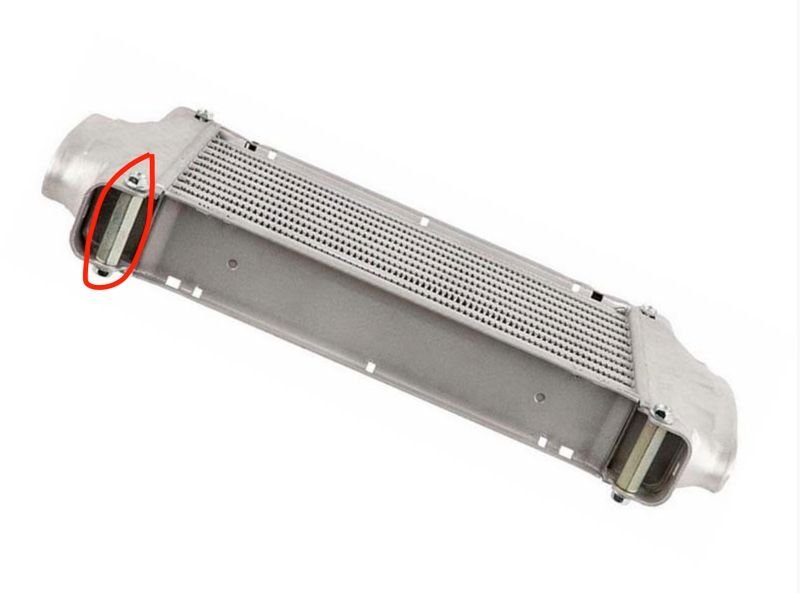

Mine seems to have fallen off.
Its the bottom screw, the coupling on the side, and the top bolt that would attach the intercooler cover to the intercooler itself.
Can't seem to see the parts online. Any ideas?

I have the same things as you but only on the back of the intercooler. On the front it is the pic I posted.

yep, not a separate part. Part of the intercooler. Might need to go to a hardware stor and look for a tube washer or try to make one.

Looks like a coupling nut. Designed to put in a bolt from both ends. Take one of the bolts (or one the same size) to a good hardware store and ask for a coupling nut for bolts or "all thread". They should know what you are asking about.
OR, just buy a new intercooler that is clean and may cool and move more air than the 10 year old intercooler you are playing with now.
