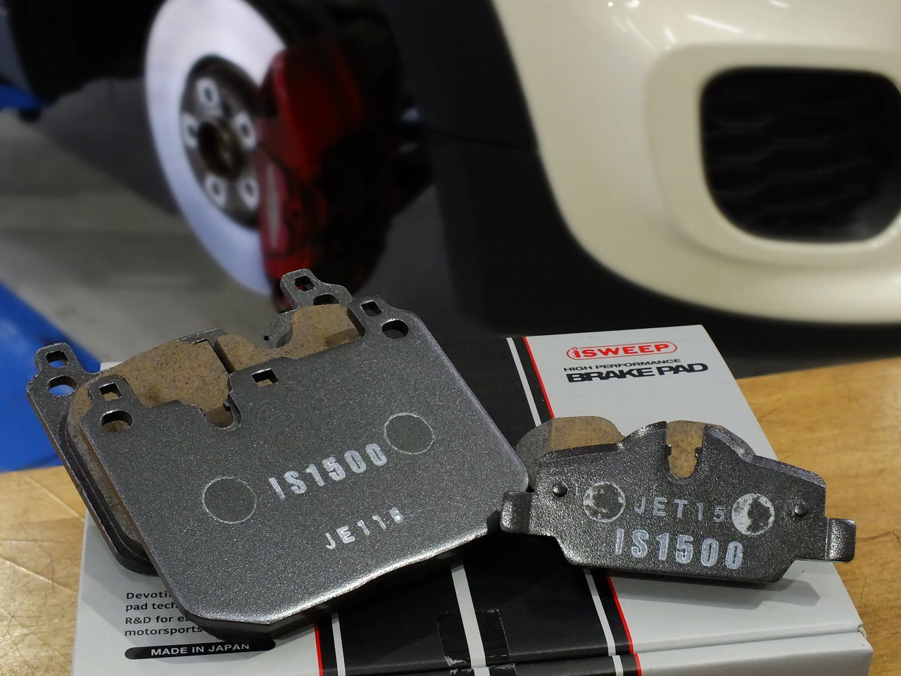

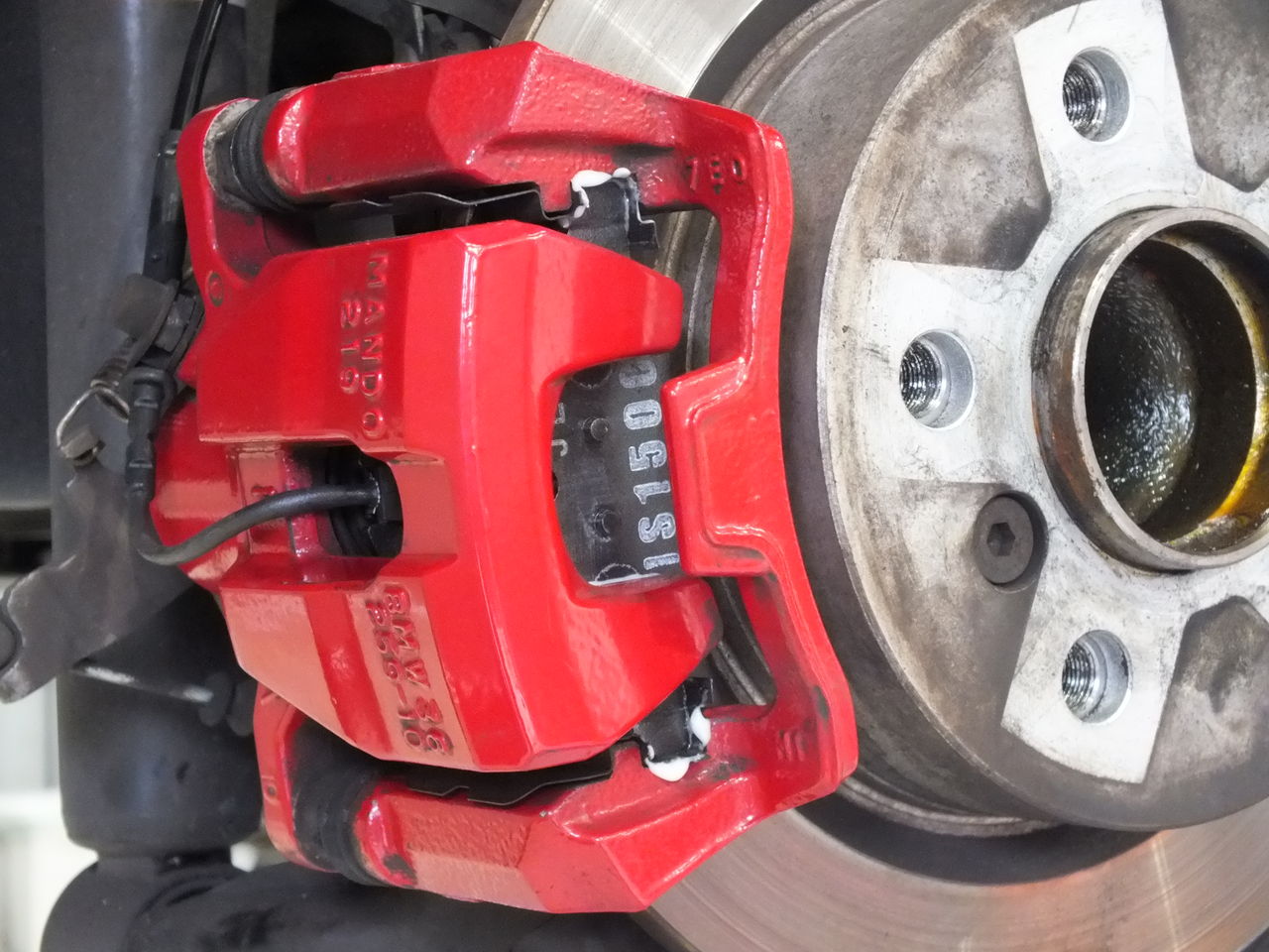

Maybe they were confused or something since it has a different part number then the Cooper S versions. We can reach out to them.
The oem ones just have the tab and not hook, they might have not updated the picture. The Factory JCW pads have the same backing plate just have a different friction hence the different part number. We had a couple people fit them already.
https://www.ecstuning.com/Mini-2018-...Braking/Pads/2
Isweep japan has also installed them and confirmed: https://livedoor.blogimg.jp/ie_staff...d/3da02bf4.jpg
https://livedoor.blogimg.jp/ie_staff...f/bfd237dd.jpg
We will be adding those soon.
