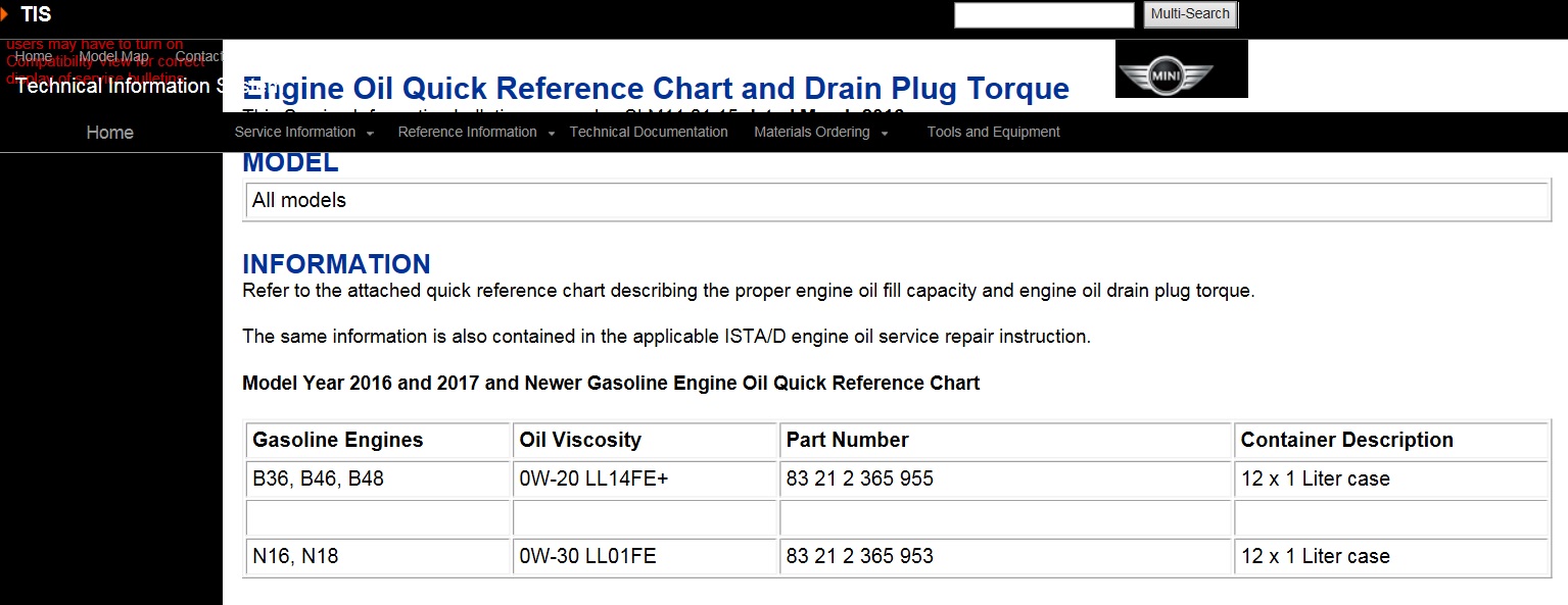

The info can be found in the TIS Technical Information System. "Engine oil Quick Reference Chart" - Came out on August 1, 2016.
Here's part of that chart in TIS.
Old Sep 6, 2016 | 01:31 PM
Posts: 36,766
Likes: 2,552
Yes +1 this is new for the 2016+ . Thanks for posting that up Gray Raven. MINI just added the 2 different oil types for the newer engines. I got the handout from MINI corp. a MINI event.
83212365955 is the new 0w-20
and 83212365953 is the new 0w-30
