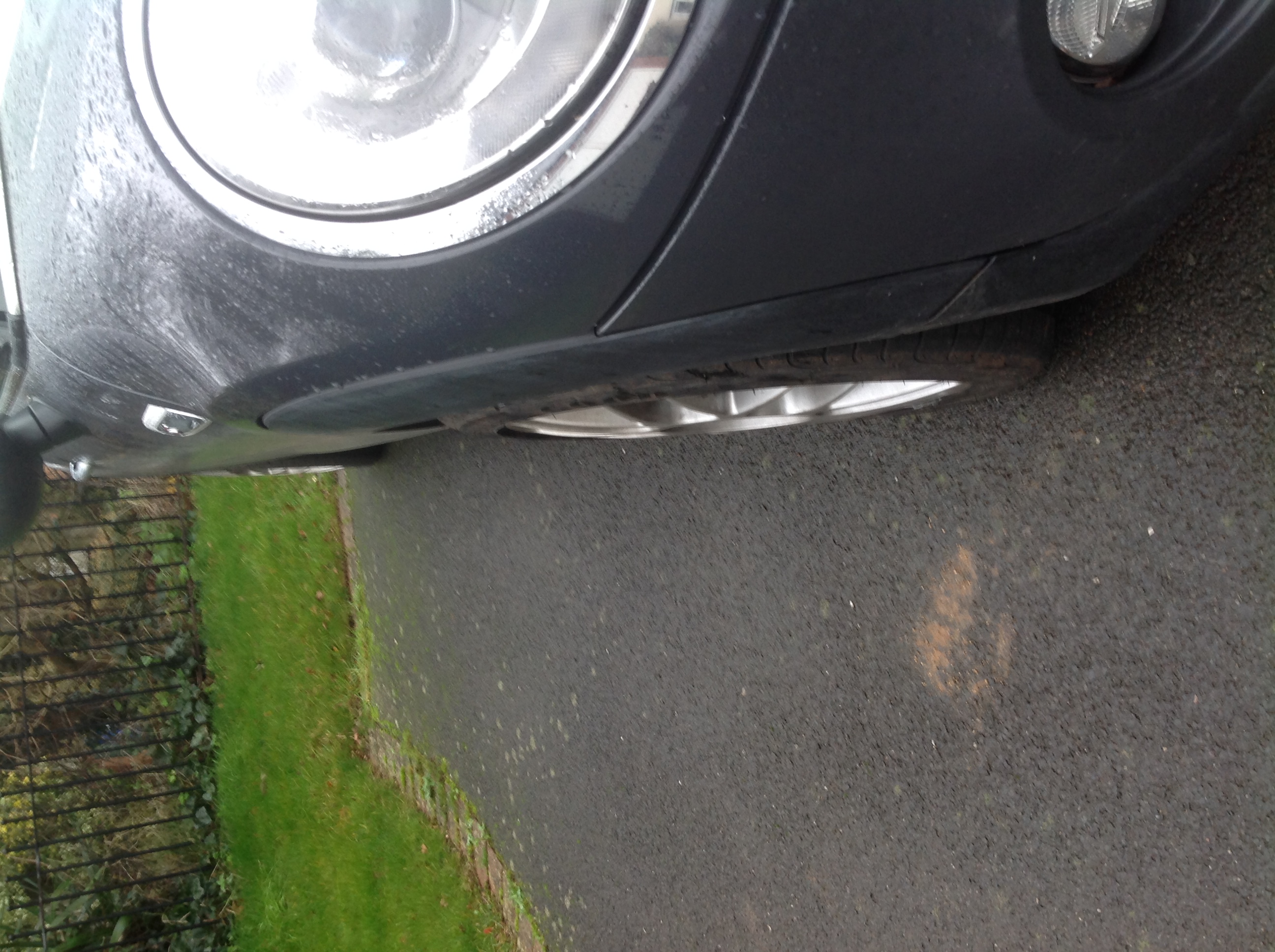

If it helps I'm running 7.5 x 17 with ET43 and 215 section rubber but with BBS wheels
