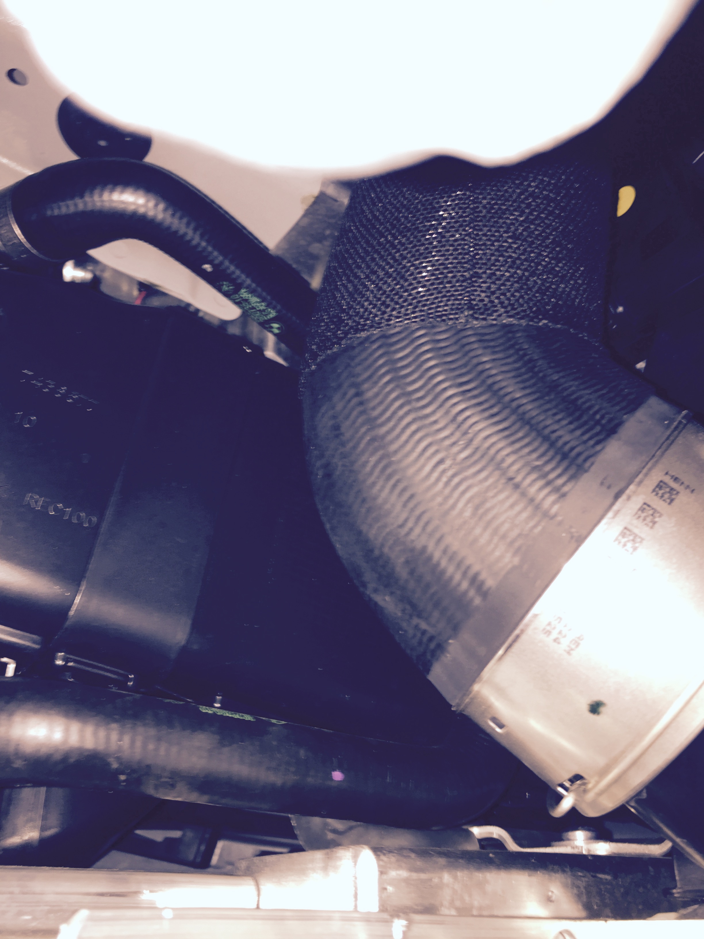

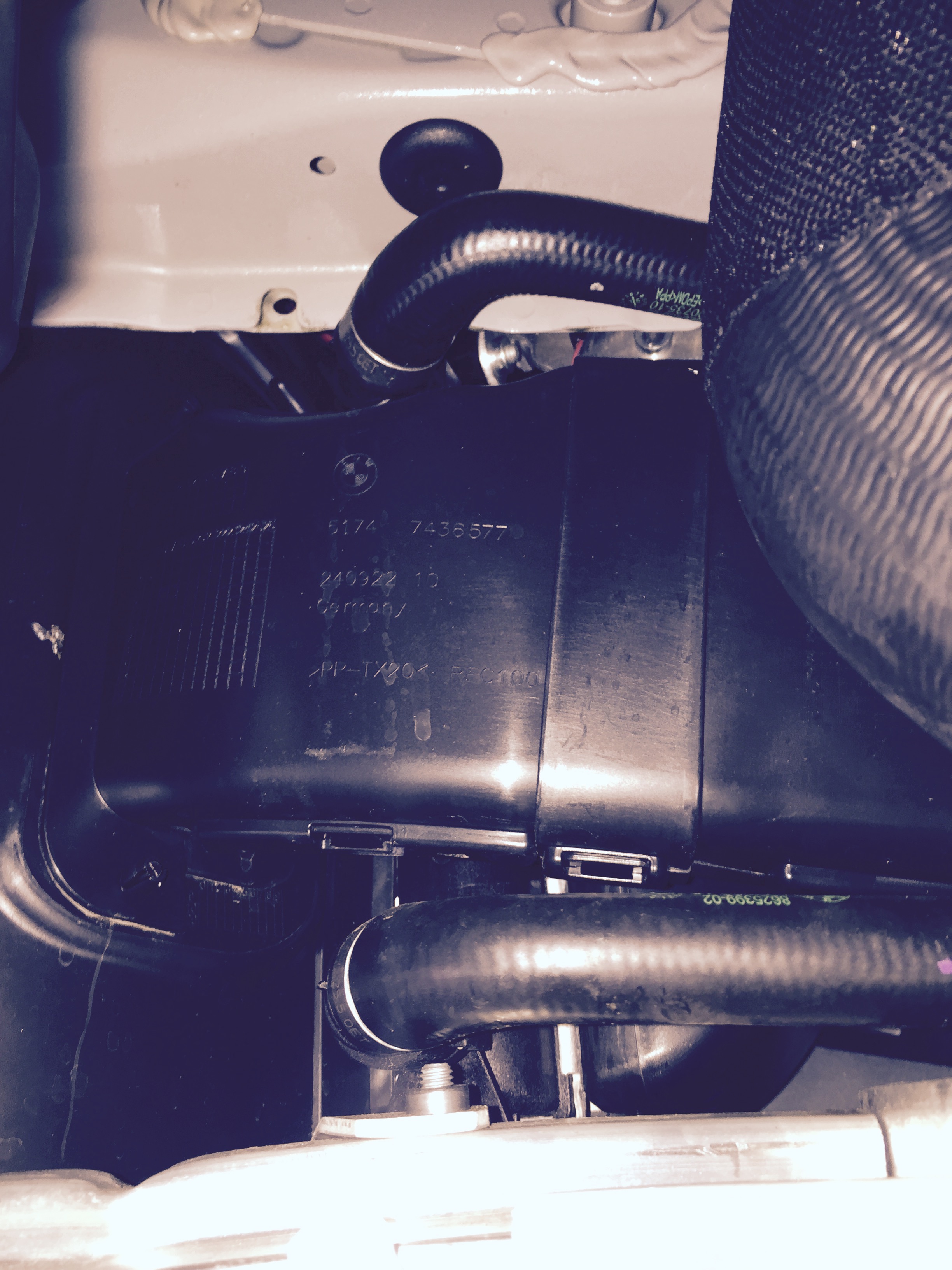

Originally Posted by Ryephile
Excellent, please take pictures! of the extra cooler
OK, I got Ms. Agatha up on the lift Sunday and the pictures are included here. There isn't a lot to see under there but this puppy is most certainly a water core. What the pictures do show is the two hoses coming out of this heat exchanger and turning to the front of the car. What you can't see is that they then turn to center and enter/exit the left side of the radiator. I thought this item might have been dedicated to a particular function but it just seems Mini needed some extra water cooling capacity and a larger main radiator was not the path taken to solve the issue.
JCW Extra Oil Cooler-jcw_radiator_2.jpg JCW Extra Oil Cooler-jcw_radiator_3.jpg
Old Sep 22, 2015 | 12:24 PM
Ryephile's Avatar
Ryephile
Joined: Jan 2003
Posts: 9,009
Likes: 36
From: Metro-Detroit
Thank you for posting your findings! Supplemental coolant radiator just like BMW's appears to be correct.
