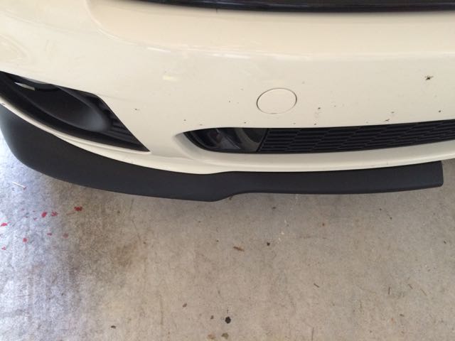

New construction and hit too high an entrance that broke the left front spoiler. I only saw 1 clip broken but it also was an end rivet. Was holding fine until about 200 miles on the Interstate and it left me. There is one broken clip (red oval) and I'm left with 1 plastic revet that needs to be removed (green oval), I think. Does it look like a new one would snap back in place and hold? Is there a way to repair the broken clip (epoxy??)?
Sorry for the nasty car but just got back and 450 miles with 225 in the rain.

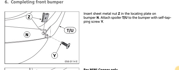

Just to add: It's not a rivet but appears to be a self-tapping screw that I will need also. After looking this is probably the most important supporting part of the structure. So once it broke it was probably only a matter of time before it let go.
I have bought from ECS Tuning before but can't find the part (or parts now) on the site.

Looks like you have the JCW Aero II Kit. W/O painted blackline.
They take a little more aggressive lower lip then the JCW Aero I kit.
51110441461 Left ( driver side )
JCW Aero II Width Extension - left
http://www.ecstuning.com/Search/SiteSearch/51110441461/
JCW Aero II Width Extension - Right 51110441460
http://www.ecstuning.com/Search/SiteSearch/51110441460/
There is also a delfector lip below the lower lip on each side that gets knocked off.
Deflector Lip - Left 51110445079
http://www.ecstuning.com/Search/SiteSearch/51110445079/
and
Deflector Lip - Right 51110445080
http://www.ecstuning.com/Search/SiteSearch/51110445080/
For the hardware:
http://www.ecstuning.com/Search/SiteSearch/51471911992/ES2676227/ x 4 total.
http://www.ecstuning.com/Search/SiteSearch/07129904150/ x 2
http://www.ecstuning.com/Search/SiteSearch/07147129160/ x 2
Looks like the MINI digrams above is for the JCW Aero I kit ( without the brake ducts).

Looks like I have the wrong PDF then. I do have the brake ducts and the spoilers look like the ones you posted. Will get it ordered.

That lower lip and the brake ducts combo point towards the JCW Aero II kit.

Can you post a link to the PDF for the JCW Aero II. I can only find the original Aero kit PDF. I may ned it to install the replacement parts.
Old Jan 15, 2015 | 01:01 PM
Posts: 36,766
Likes: 2,552
Attached.
File Type: pdf
