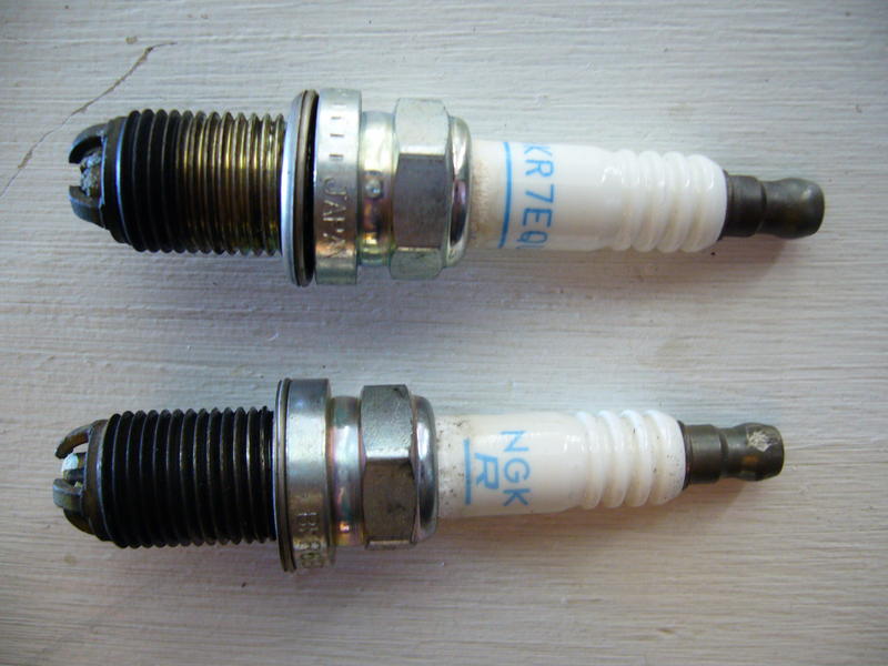

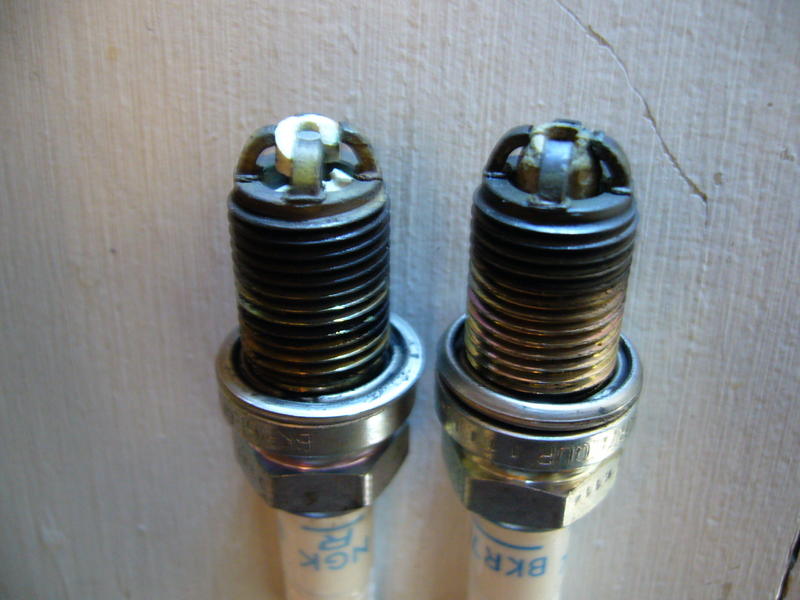

Attached are the 2 plugs that has caused my problems. Like I said 1 was in cyl. 1 and lasted about 1 year and the other was in cyl. 3 and lasted about a month. Both came apart the same way. It appears to me they got to hot.

If the BKR7's are fouling, why would you want to go colder? Seems to me, that would foul even more. Have you tried BRISK DOR14LGS plugs? Pricey but excellent.
