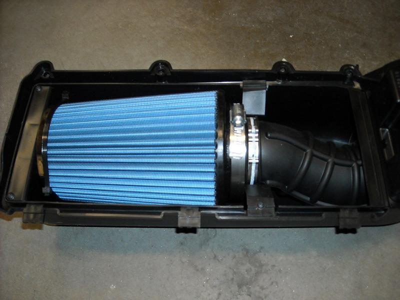

Originally Posted by slinger688
Do NOT put an aftermarket filter on this if you cannot properly secure it on both ends like the OEM filter as it can fall off and you will be left w/o a filter. Filters like Alta cone cannot be secured at both ends but others like Mini Madness can. That said, I would still tend to keep the OEM paper cone filter.
Not true...5000 plus miles and it hasn't budged one bit. (and I was just in there 3 days ago) Even a road trip from Denver to Vegas for AMVIV didn't budge it. It's all in the way you mount it.
