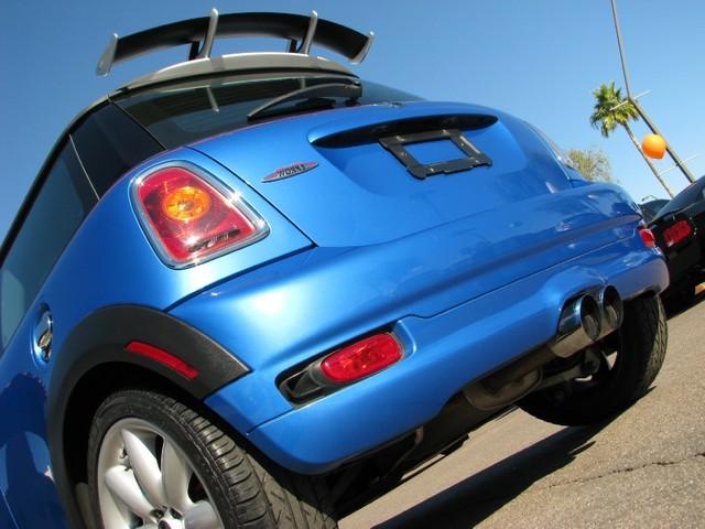

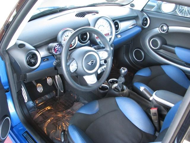

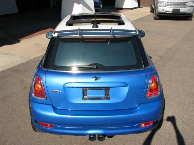

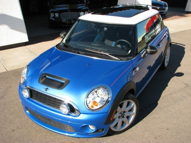

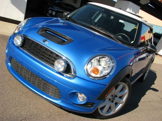

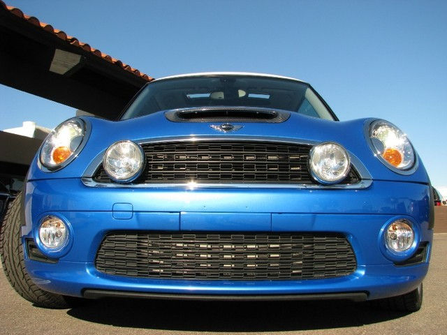

Basically, Im going to be looking at 2007 JCW Mini, from the pics it looks like its a JCW but then I guess you can just buy the parts and throw them on.
It has the driving lights, the JCW CF rear spoiler, the exhaust looks meaner then the cooper s, but its has the normal crown spoke 17 wheels, it also has a CF hood scoop thing and CF mirrors. And it looks like it has the Cooper badges on the rear and inside.

The new body style or R56 factory JCW was first made in 2009. The car you are looking at is a Cooper S with either a dealer installed or port installed JCW tuning kit which does not provide the same power, pistons, brakes, etc as a true factory JCW. If you want to stay in that price range, though, I'm sure you can find a 2006 R53 Cooper S with Factory installed JCW tuning kit. This is a true JCW in my book, a ton of fun to drive, however the older body style and supercharged rather than turbocharged.

Actually, looking at the exhaust pics, it doesn't even look like it has the JCW tuning kit. Just looks like it's a Cooper S with some JCW accessories/parts and emblem installed. If it had the JCW tuning kit at the least, the exhaust tips should have the JCW insignia, should be a badge in engine compartment with special number and intake with JCW insignias. This car does indeed look like a wannabe. I don't think an 07 S with a JCW tuning kit is a true JCW and it's definitely not if you just throw a few JCW parts on with an emblem. Just my opinion.

Yeah, it just looks like the tuning kit. Like BigAl said, factory JCWs didn't come out till 2009.
Al, the exhaust pipes on the JCW tuning kit are a bit different than the factory JCW. The car in the pics above does look like it has the tuning kit exhaust from what I can see.

I know that, that is why I said the exhaust from the tuning kit would also have the JCW insignia on it while the factory JCW exhaust does not. It just almost looks like it is an OEM R56 S exhaust with bigger tips which are widely available pretty cheap so just wasnt sure.

Ask owner if it has the JCW serial number plate on the engine and if he has the JCW seal of authenticity document that the dealer provides with the JCW upgrade. It is definitely not a JCW factory car but if it has the JCW tuning kit then it is still more desirable than a standard S. I should know.

That's a nice JCW Stage 1 MCS but (as has already been said) it's not a factory JCW. What's a bit puzzling though is the dealer. Are they trying to pass it of as a factory JCW or are they unsure? If they're not sure that's fine, but if they say 'oh its a factory JCW alright', then they're plain lying.
