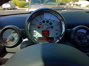

Originally Posted by Jjvanwingen
A daytime photo would be VERY helpful-- I've been scouring the net looking for a good one with the temp gauge (they're all of the other two gauges). My new JCW will have a dark grey speedo and tach (new this year). I hope they're not hard to read in the daytime!
I took a bunch of pictures and this is the one that I feel best matches what my eye sees (exposure, shadows, etc).
if you want to compare night/day images a little easier…
