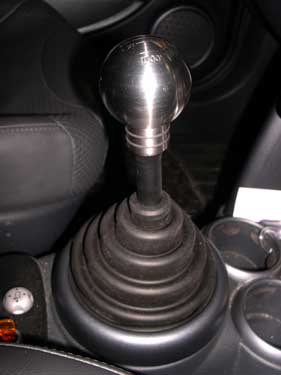

finally got the Audi TT boot and it fits
ok guys, i got my TT shift boot and it fits with a little modification. Basically I had to cut a few more holes, because not all the stock holes line up. The TT boot looks a bit smaller than Tiburon aftermarket rubber boot too. I couldn't quite make the top hole cover of the shift boot cover the bottom shaft notch because its shorter than the Tiburon boot. I stuck a rubber 1/2in grommet on the shaft to keep the dirt out at the top boot opening.

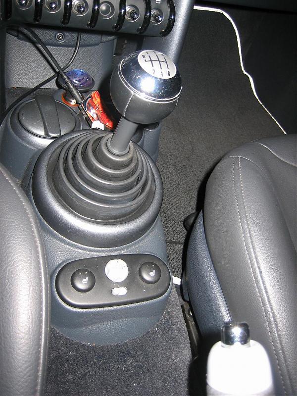

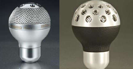

I personally would rather have the Tiburon boot because its bigger, but I can't find them anywhere, although without them being side by side the TT boot is growing on me. The folds have sharper edges, kinda sleeker if you ask me. I might even cut 1-2 inches of the shaft with a dyegrinder once I find the perfect shift ****. Everyone seems to like the whalen *****, but they look a little boring to me. Maybe one of these MOMOs?
I'd love to hear everyones thoughts.
(first pic is of my TT boot, second belongs to another member on here just for comparison, third is of some Momo ***** I'm looking at)
