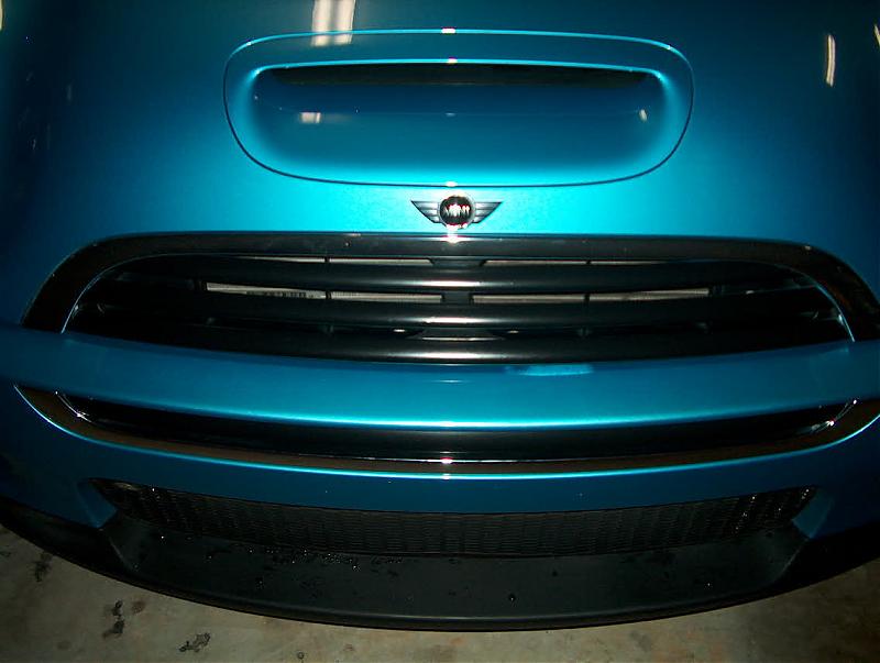

Here is what the electrical tape looks like. This was after a day of driving on snow melted roads and an automatic touchless wash.
From a distance it looks good.
Here you can see the seam/bump from the tape layers.

Looks really good! Adhesive vinyl is super cheap at sign stores, like $3 a yard. It may be a cheaper option for you and it is easy to fix/replace if it gets damaged unlike paint which tends to be costly.

I'll have to go to Home Depot and get some wider tape. I did this mod it about 15 minutes so its kind of a hack job.

I know that there is "blackout tape" that's made that's wide enough to cover the slats... I cut my strips to 1 3/8" (for lots of details of my install process see THIS THREAD) and they were wide enuogh to wrap around just dandy. So, anything that's a AT LEAST that wide will do you.
Also, I notice what looks like bubbles and such in your close-up photos... I found that if you try to do a "dry" install that the chance of getting wrinkles and bubbles is very great, but if you use the "wet" install technique (i.e lightly mist the grille with water with a drop of dishwashing liquid in it first) that the vinyl can "slide" around and more perfectly adhere. The wet technique, once mastered (I wasted one vinyl strip, just tinkering with the installation technique) is VERY easy compared to the frustrations of trying to get it to apply properly when dry. I didn't even have to pop any bubbles trapped beneath the vinyl, even, and as you can see it's perfectly smooth, from 6 yards away to 6 inches.

Some of what apear to be air bubbles on my grill are infact bumps from numerous rock chips. After each chip I cleaned it out, and used the factory paint touch up and clearcoat sticks. It doesnt really bother me, the only way out is a new grill which I might just do anyway since I like the black. Does anyone know if I could reuse the grill chrome? I noticed on later model minis that the chrome lost some lines it has on earlier ones.
