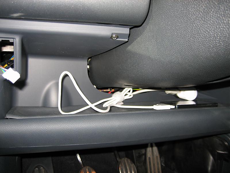

shelf w/ power and ipod interface
I just finished my shelf install yesterday. I too did a power outlet install along with rerouting my existing ipod interface to fit neatly and cleany within the shelf. The result is a very clean and unobtrusive ipod hookup with all cords and power cable bundled out of site behind the drivers side footwell, out of reach from pedals and whatnot, including the add a fuse circuit being contained within and behind the fuse panel. See below for pics and let me know if you have any questions. I am still working on fiting the driving light switch within the supplied blanking plate and then it will all be complete.
TJM

BTW, even with all this stuff into the shelf install, this was a fairly easy process. Time consuming yes, but difficult no, and I am not even good with electrical stuff. Do not let this frustrate you guys...just take your time and do not be afraid to push and pull when needed.
