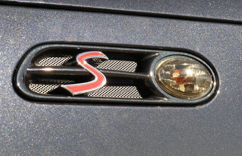

I also disassembled a pair of side grills and got the chrome section painted. This was also done along with the Aero kit, so it didn't cost much.
This is the first time I've tried to post pics. If they dont' work, just look at my gallery.
