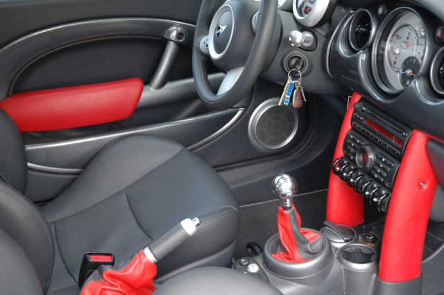

OK- The project has gone well even after a few mishaps with mismatched leather. The first run of leather looked a little to bright but I did the armrests anyway. Well it was way o bright and I wanted it toned down. Yesterday I got an entire Hide shipped that looks fantastic.
I have included some pics.
I have not had the time to remove the door panels to do the inset of the panel yet but will once I go to the service department and have them put all the bolts back that they left out the last time they were in the door.
Anyway. I did both armrests and the downtubes to try it out and I think it rocks!
Let me know what you think. It is not a hard project, just time consuming....
sorry for the mess in the car but I haven't had time to clean it all out!
chris

Did you cover the downtubes in leather? It looks good!

Thanks!
I did cover the downtubes in the same leather that I covered the arm rests...
It was some work but worth it I think!

that looks really nice mate where about did you join the leather on the downtubes round the back out of sight really inpressed im just trimming mine at the min in ice grey leather and alcantara. any more pics of the downtubes. top job
