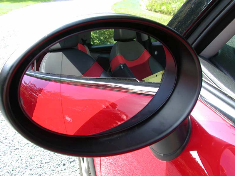

OK, here is an admittedly hurried up-date on these mirrors. My brother dropped it off over the weekend and I have just CONFIRMED that it is plug 'n play; pop out your original factory mirror(s) and pop one or both of these in their place; they are also, in fact, heated. I ordered just one, a Left, but cannot imagine why the Right would not fit. I'll post a few quick pics; I'll take more and post them later if there is interest.
Part Numbers:
LEFT Aspherical mirror glass heated 51 16 7 160 775
RIGHT Aspherical mirror glass heated 51 16 7 160 776
The Left one I now have was priced at 22.94 Pounds Sterling through a MINI dealer in Oxford; that's around $41 US.
As to HOW to get them, I honestly do not know if any US dealers have access to non-US parts.
I've confessed to being a long-time fan of these split mirrors so telling you that I like 'em seems kinda silly but I really am glad to have it.
Wait, so this factory part is a "split" type mirror and not just a convex mirror that makes things seem smaller like the standard right mirror? Gee - I'm all over that!
Sorry if the question seems rhetorical. I just want to make sure I'm seeing/reading correctly.

Another photo ...

Yup, this is a factory split mirror; no double-sided tape or any of that mumbo-jumbo. These are available in UK (and Europe); not sure about US.
