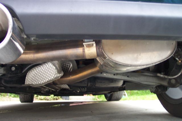

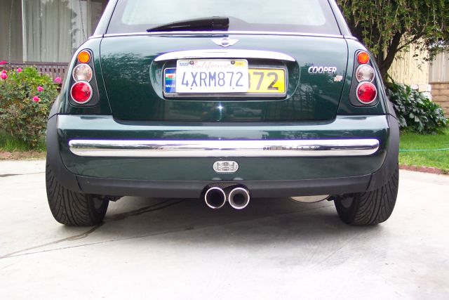

I did it to mine and it was a bit of work. I purchase a quicksilver exhaust and it fits great. The only thing that took the most work was the mounting brackets which are a bit diffrent from a MC to the MCS. You also need the side and bottom black trims from a MCS and depending on the exhaust, you need to cut the heat shield. After everything was done I love the deep tone it has . It sounds like a bit of work but once you aquire all the items everthing falls into place
p.s. I forgot to mension that i no longer have space for a spare .
