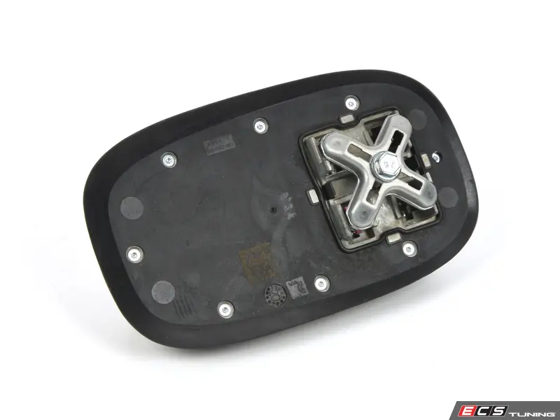

Hey guys, does anyone know where I can get information on how to remove the antenna on the roof so I can have my roof wrapped

If its designed like the last MINIs, you have to drop the headliner a bit and then access the weird bolt/nut. You can see it here on this part. Then it should lift off the roof. You have to unplug all those connections on the main harness to it also.
https://www.ecstuning.com/b-genuine-...a/65208782589/
