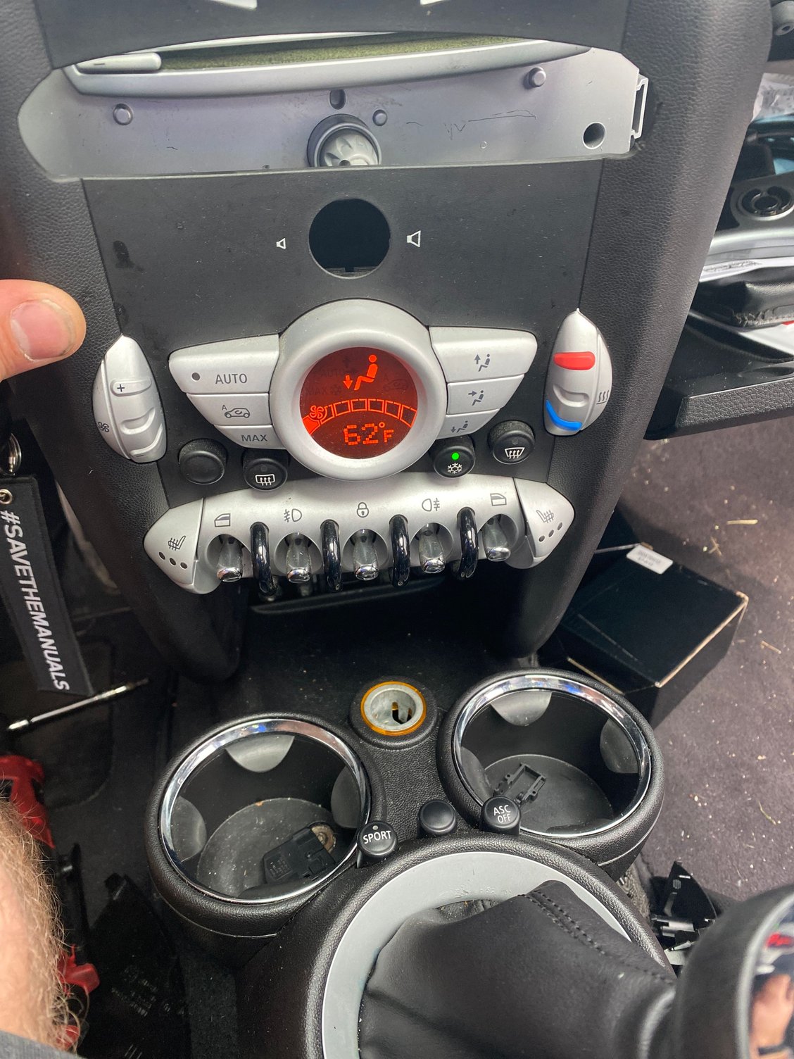

so i have a 2007 JCW with manual hvac controls, i’m trying to swap in an auto hvac set up from a 2008 MCS. some of the wiring is slightly different, one plug i can mod to plug it in, another plug gets left to nothing. unit powers up but nothing works. rear defroster works, fog lights work, heated seats work, door locks and windows work. blower motor does nothing. i can’t really find anything on a R56
auto hvac control
powered on but not working
manual hvac control, original to car
plugs and harness

Needs to be coded.

From what I have researched, you need to add the blower motor and the dash sensor also.
