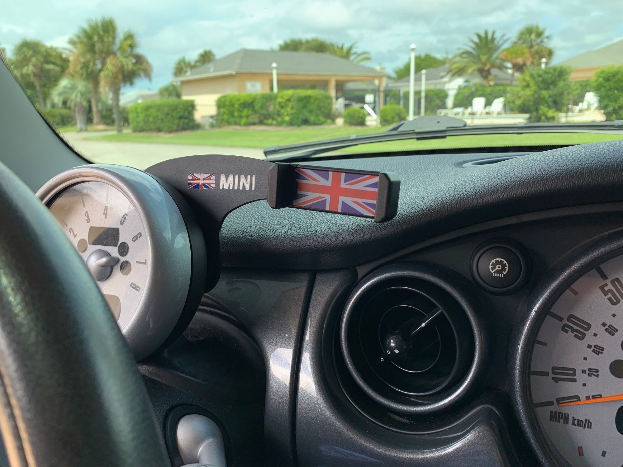

Today, I retro fitted a F56 Phone mount off ebay $14 to my First gen 05MCS.
https://www.ebay.com/itm/Adjustable-.../233222876444?
You do have to drill 2 holes in the back of your tach. but it works great!
If anyone is interested post here and Ill write up a DIY,
(I did widen the holes a little to accept the bolts on the metal mount arm, see pics
You'll need
Drill / Drill bit
2 short bolts, washers, nuts (I used allen key bolts and lock nutz)
Torx bit (to remove gauge) t25?

Hey DiscoDave, just make sure you get the F56 (3 gen) mount NOT the R56 (2nd gen)

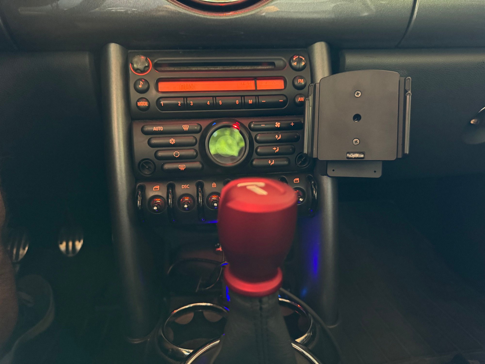

Rennline has one for the R50-R53 now. Down near the down tubes. So thats an option.
https://www.ecstuning.com/b-rennline...3/pm01.61~rel/

That’s a nice clean install. Of course he did it on the pre FL downtubes, which pull right out. FL requires removing the center console. But I believe you can get enough room without removing them.
