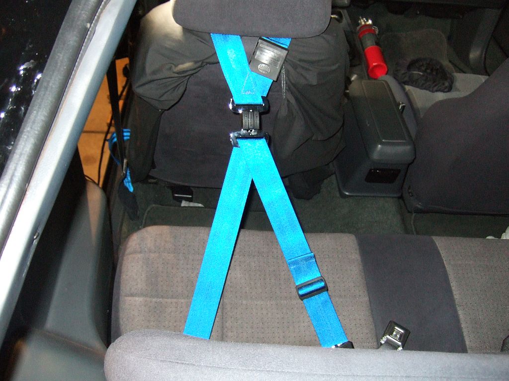

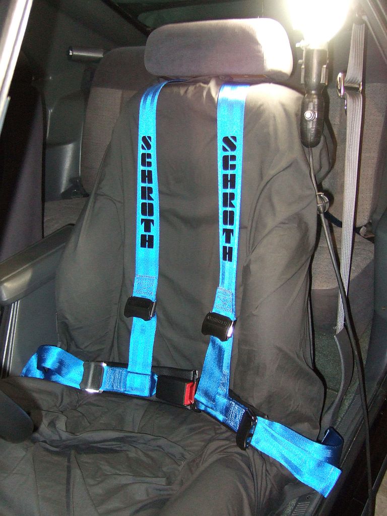

It is very true that you should NOT use racing harnesses on the street, results will not be positive in relation to the stock belts. Schroth does offer DOT legal harnesses that will work on the street or can be moved out of the way for use of the factory 3-point belt. Schroth has a good amount of info on the technology on their site here:
https://www.schrothracing.com/technology
I use their Rallye 4 ASM harness in my Mustang (see below), but I only use them when on track even though they can be used on the street.
Attached Thumbnails Schroth 4 point belts on F56-harness-schroth_rallye4_drivers_01.jpg   Schroth 4 point belts on F56-harness-schroth_rallye4_drivers_02.jpg
