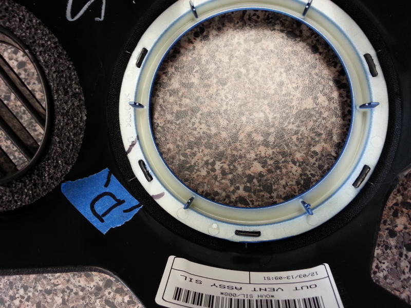

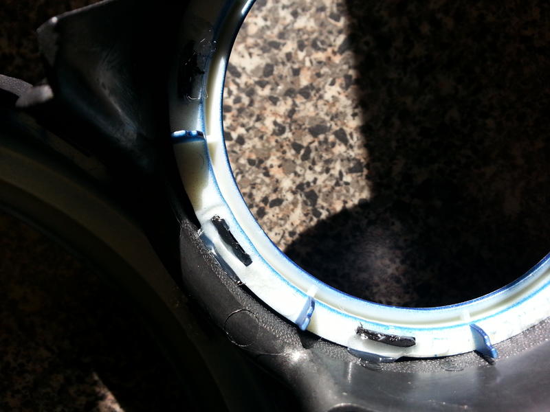

The tricky thing is that to paint the inner part of the trim rings only (silver in my MINI), it is really best to remove them from the black outer trim. This is because it would be very difficult to mask this transition from inner to outer trim and get paint into one side of the crack and not the other. See attached closeup of where they meet (taken after painting).

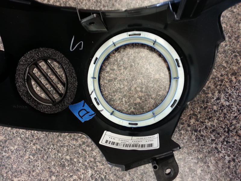

This is where it gets tricky, because the inner plastic piece is attached to the outer by way of tabs (from the outer) pushed through slots (in the inner) and then heat-bent (see attached pic of back of one of the side vents. The inner trim is light, the outer is dark. There are six of these tabs).
One way to get these tabs off is to use a micro-hot air jet, if available. Warm the tabs and bend them back. However, this is tedious and runs the danger of warping the trim. I found it much easier and quicker to simply dremel the tabs off to where they are flush with the light inner trim.

reattaching inner trim to outer trim ring
To reattach the (now painted) inner trim rings to the (black) outer trim, press back into place so that the sad little remnants of the black tabs just poke into the slots of the light inner trim material. Hold in place and then fix with hot melt glue (see pictures). Make sure the hot melt glue is hot enough. I did 2 tabs at one time, let set, and do next 2. That way you can make sure all are well pressed in and secure. The last picture here shows the dis-assembled dash, with the left vent trim reattached after painting, all else still in bits and pieces. Notice the A-pillar trim removed.
That's about it.
