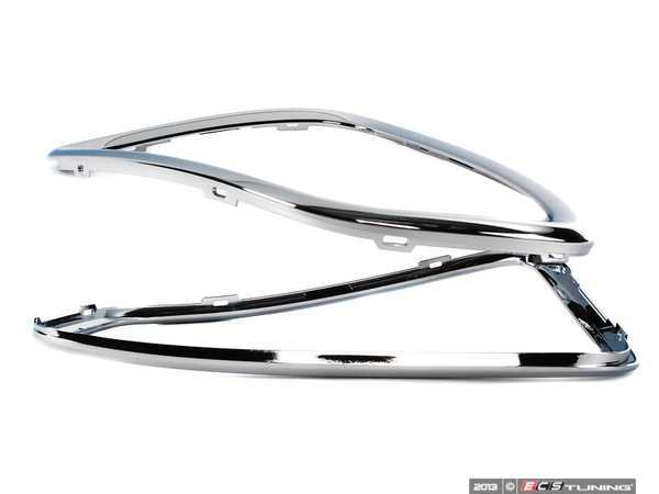

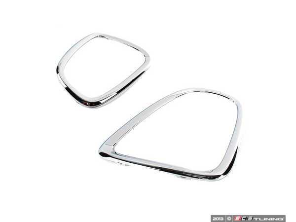

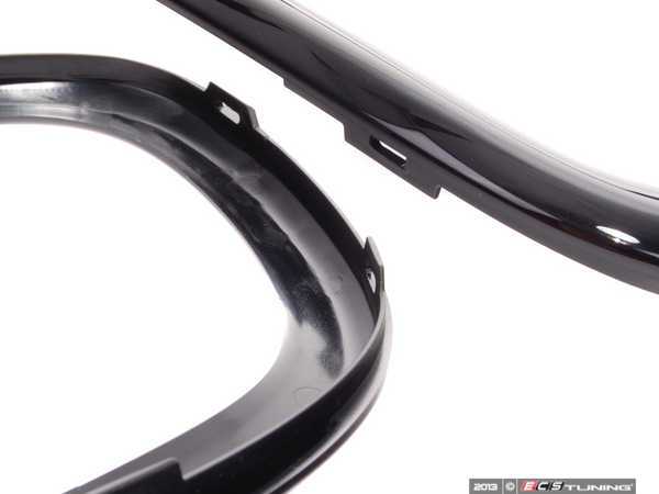

I go from under the hood and press them out with a plastic or metal trim tool. Watch the trim clips and make sure when you clip the new one it, its clipped tightly all the way around. Know a couple of guys that had them fly off down the road.
Black line version
Chrome version ( same as black line , just different color trim )
Here is a nice video an R56 owner posted up for the headlights and taillight rings in black line, same procedure for the chrome one.
And here are the parts if you need a change or replacing a damaged one.
Headlight Trim Ring Chrome - Set Part number 51137149905KT
http://www.ecstuning.com/Search/SiteSearch/51137149905KT/
Headlight Trim Ring Jet Black - Set Part # 51132254895KT
http://www.ecstuning.com/Search/SiteSearch/51132254895KT/

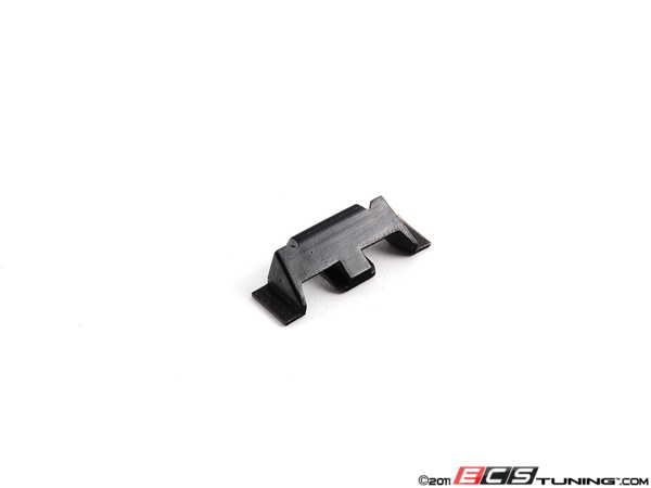

They are right here, 6 per headlight ring. We usually have them in stock.
Clip - Priced Each Part # 51132752145
http://www.ecstuning.com/Search/SiteSearch/51132752145/
