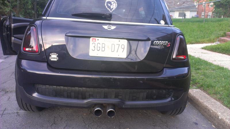

i actuaully just finished my tail lights and rings yesterday
Attached Thumbnails Light tint and ring blackout-smoked-taillights-and-rinds.jpg
